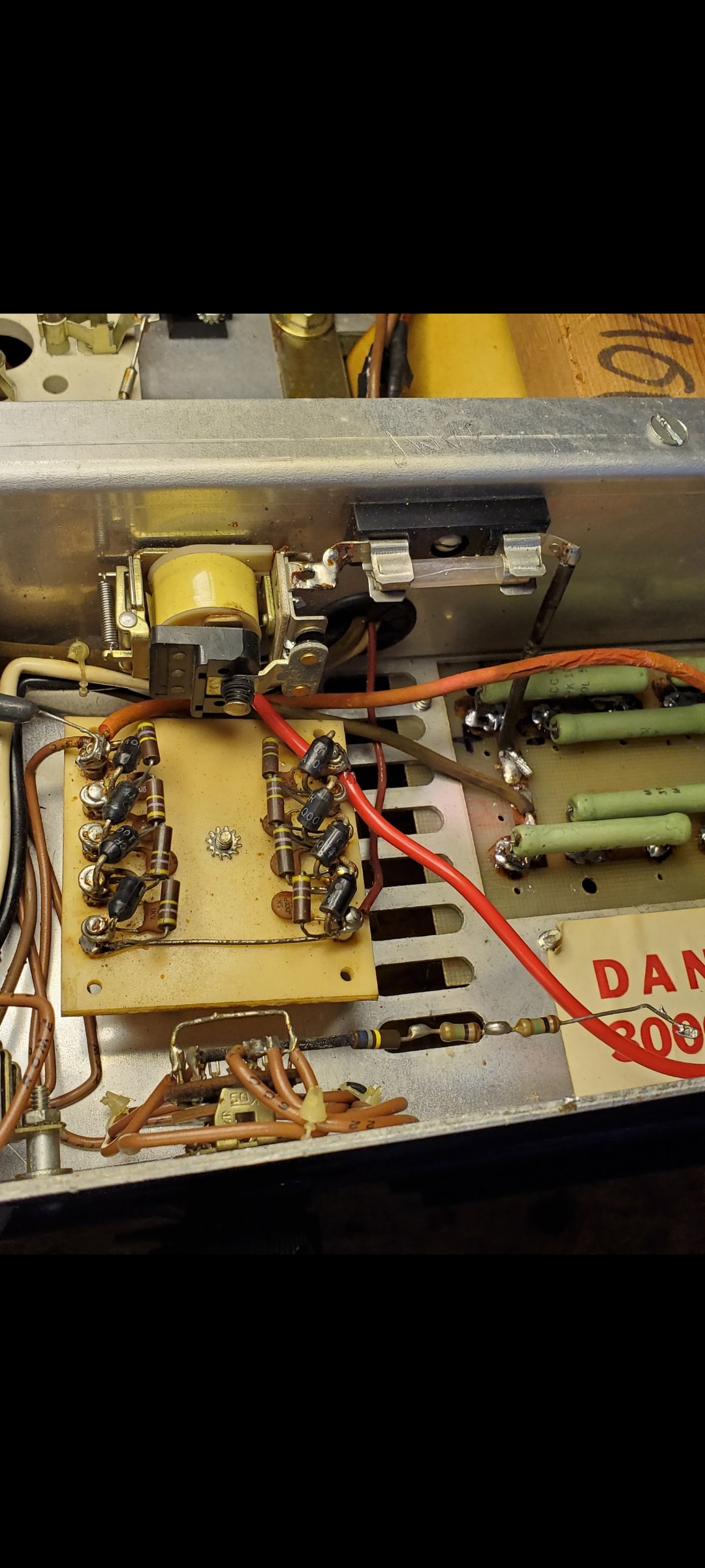

I know one thing Bayyouradio, when I got this unit all 4 diodes closest to the driver board were all blown so I replaced all 8 with 5408 diodes and figured then I had already found my problem, WRONG unfortunately

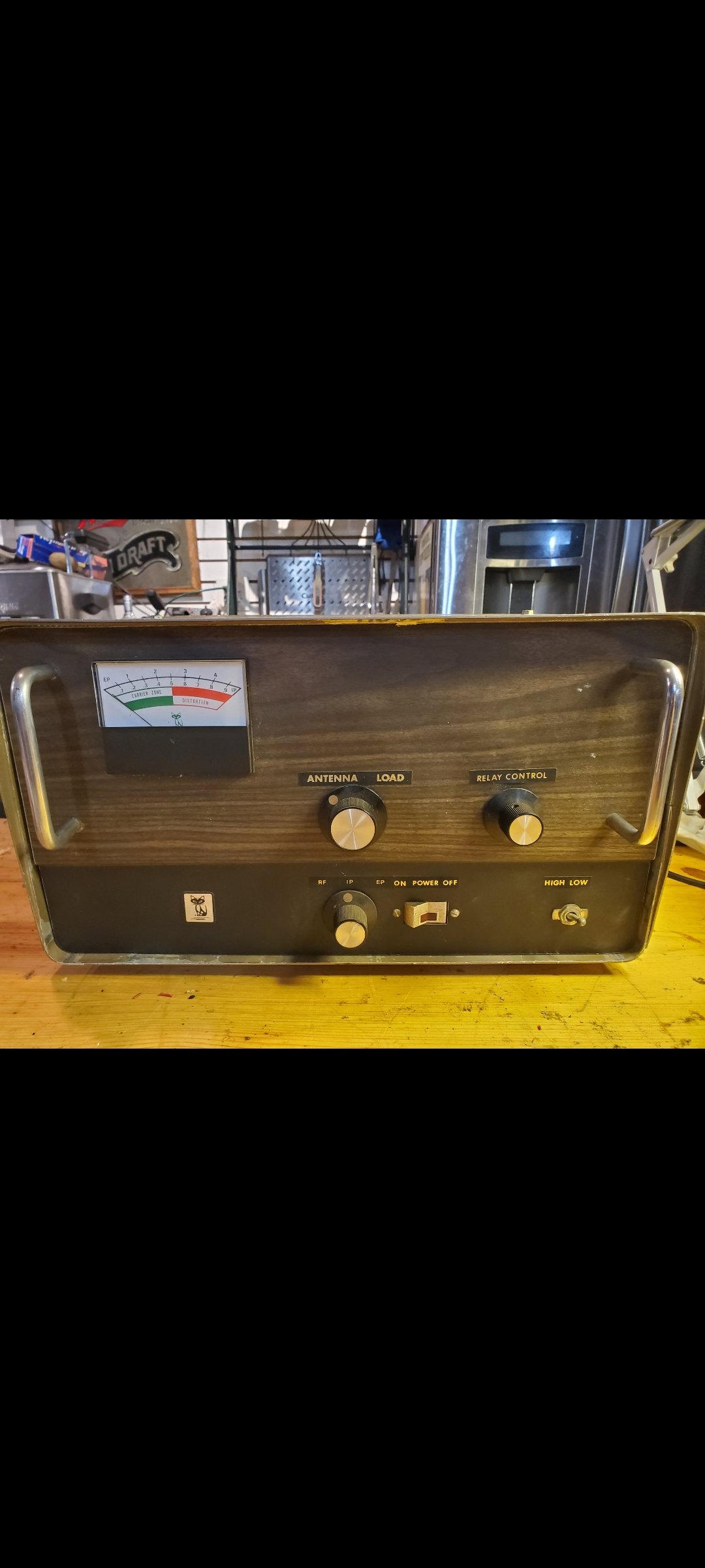

Also, all I have on the front of my amplifier is what's on this photo, other models were different I think, the one you worked on might have have 4 knobs Screenshot_20251203_221116_Gallery.jpg

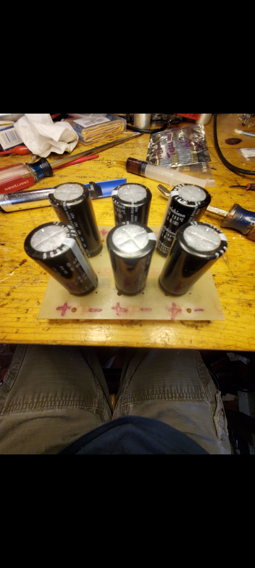

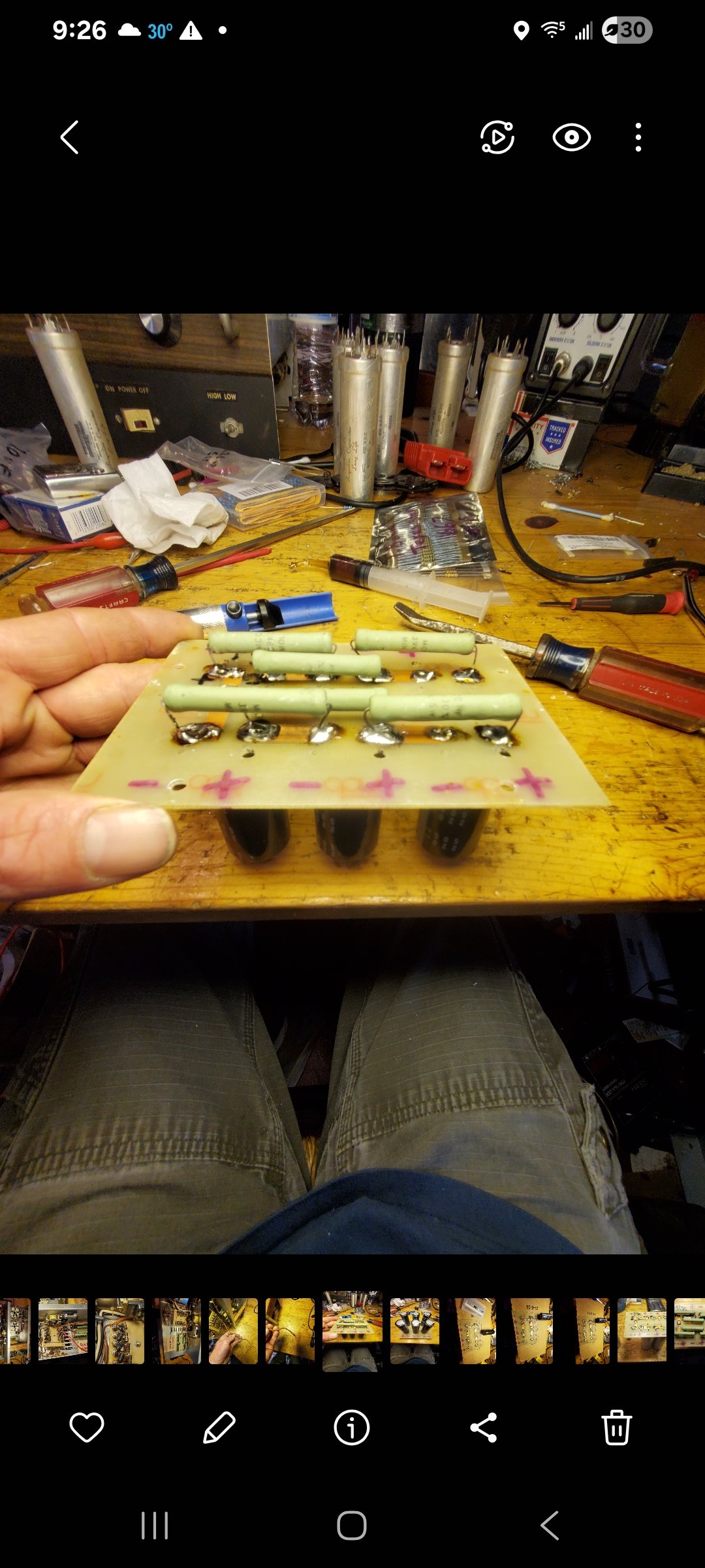

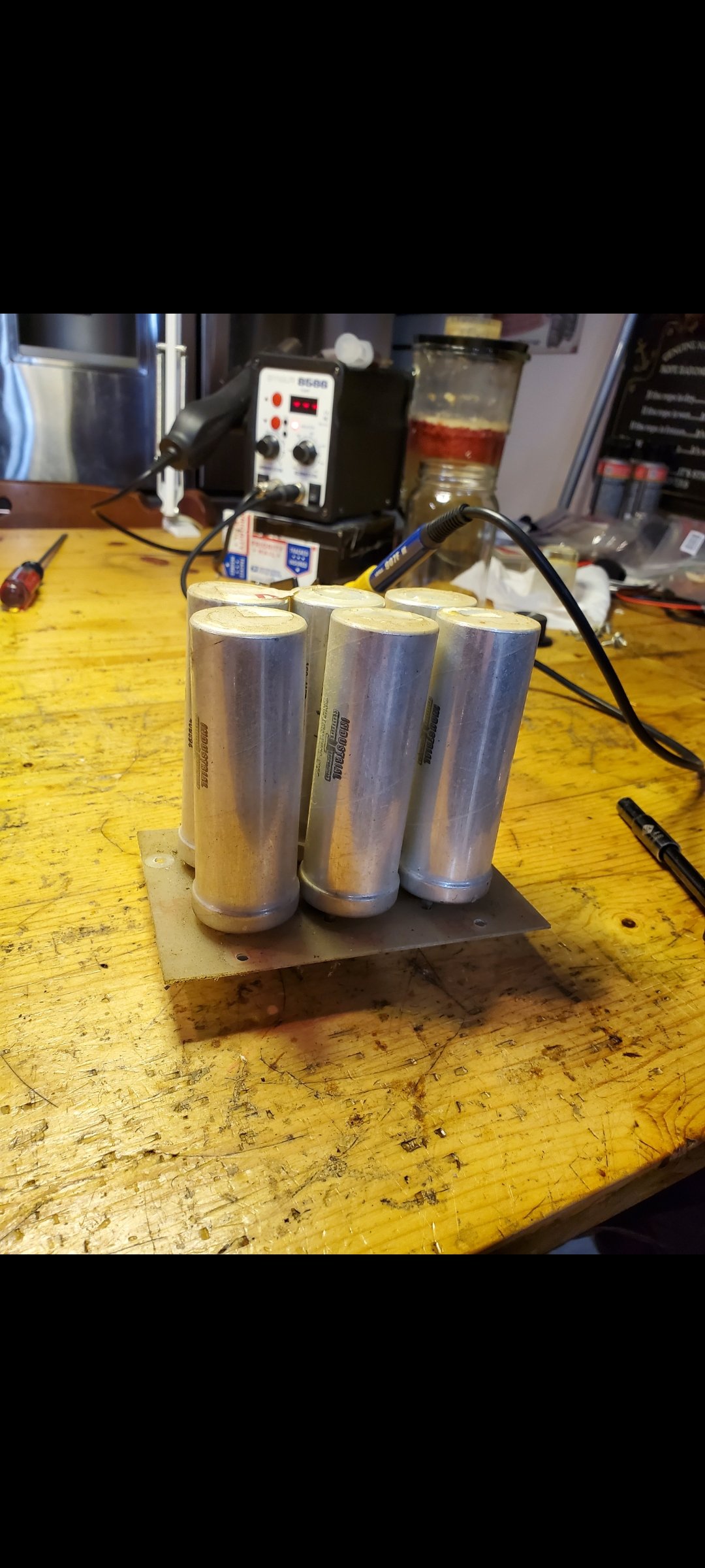

That was a picture of them before the replacement Nomad here is what went in Screenshot_20251204_011345_Gallery.jpg
