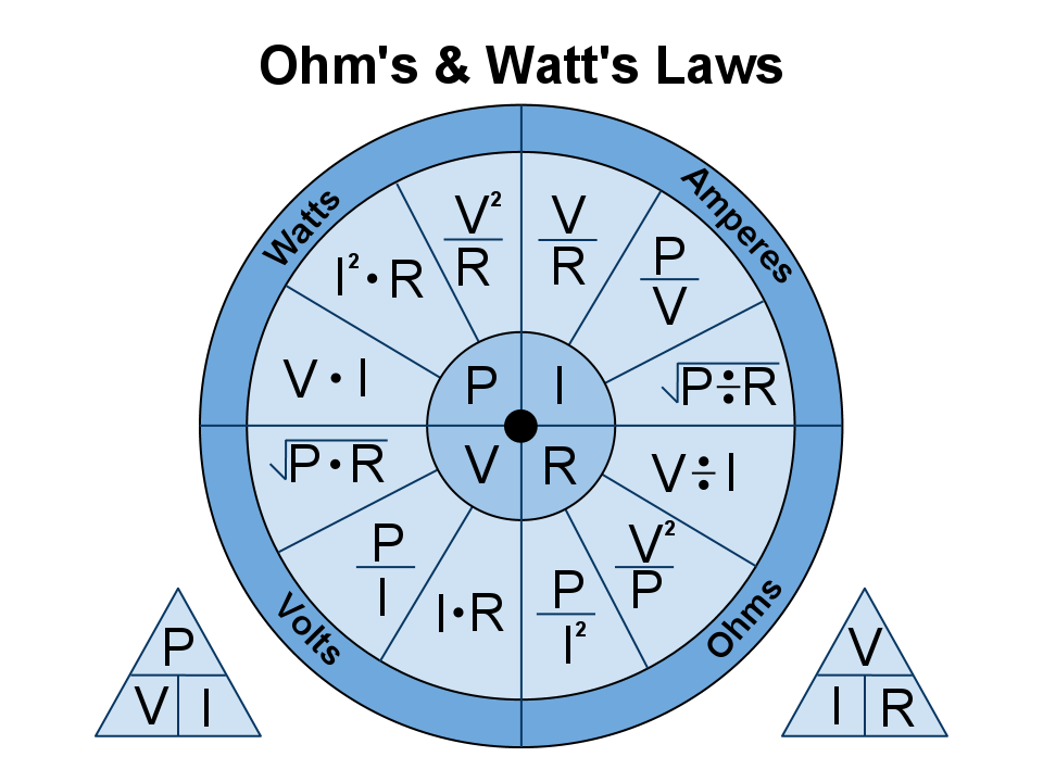

I don't what math you are using. At 13.8 volts you only need 7.24 amps for 100 watts.
Power (100) divided by voltage (13.8) = 7.2463768 Amperes. So 10 amps of DC current is more than enough for most users.
Apparently you entirely missed my post above regarding the difference between DC INPUT POWER and RF OUTPUT POWER. The big difference is EFFICIENCY. Look at my post above again. Your numbers above are based on 100% efficiency which is 0% possible. Most amps run at about 50% on average so double your numbers. Now you will see just what kind of math vkrules was in fact using. He was using the correct math, the same as I was.
