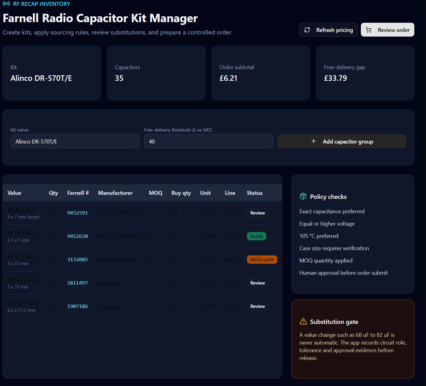

Cash or Knowledge Transfer only please. Just passing on some unfiltered learning, like the AI itself, don't take my word for it :).
Not an AI Bot but I'm determined to stay as current as possible around the things that interest me and how AI may or may not have a place. It's so hyped day in day out. Stories in press etc... It hacked this and that, its gonna kill us within 10 months, 10 years Blah Blah, we're DOOMED! DOOMED I tell ya! :cool:. My personal opinion, all hype to drive up share price. Old enough and been long enough in the industry to have seen it twice before. Ignore the noise and task it, does it boogie thats the question for me.
I get your point of EFFORT, don't disagree if you fleet in and out of it. BUT if you refine and get better with AI you can learn to get it to do the monotonous work and even begin to do to more critical tasks to a very high degree of accuracy. If configured well you won't need to tell it the same things over and over again, it will and you will refine and refine to a higher accuracy and less input from you. Basically refining rules you decide you are happy with.
True cost is always a challenge, were do you stop when calculating. The cost of the electricity to run the lights in the room where you have the computer that you investigate your cap kits, you're hourly rate for design and implementation of new cap kits, the % cost of the connectivity you have for internet..... on and on and on.
I like the extra info you've provided about your workflow and decision making points. Its as if you're setting me a further challenge :cool:
Cost is paramount when reselling components, the curation is you're USP.
And I'm honest enough to say its far from end to end but there's a certain amount of fun involved in getting to that point for this particular subject.... feeling more and more like a challenge :).
One thing though, are you happy to continue having a look over the possibilities?
Preview of the next prompt to refine the current process:
If i provide my login details for Farnell account and only work with Farnell going forward. Consider the following given what we have learned so far:
Step 1: Obsolescence & Modern Replacement StandardsFor any capacitor value that is obsolete or uncommon in modern sourcing (e.g., 68 µF), research and document:
  • Modern equivalent: What present-day capacitance value would intelligently replace the legacy value while maintaining circuit functionality (e.g., selecting from standard E12 or E24 series values).
  • Sourcing rationale: Explain the technical basis for the replacement (e.g., "68 µF is replaced with 68 µF or 82 µF as a modern equivalent; 82 µF is selected if 68 µF is unavailable and maintains the required time constant").
  • Availability: Confirm the chosen modern value is currently available from Farnell.
Step 2: Farnell Account Optimization RulesWhen sourcing parts from Farnell, apply the following prioritization rules to each potential order:
  • Minimum Order Quantity (MOQ): Identify and respect MOQ thresholds for each part; consolidate line items where possible to meet MOQ breaks and reduce per-unit cost.
  • Shipping Fee Elimination: Structure the order to qualify for free shipping on a per-order basis (note the Farnell threshold if confirmed).
  • Best Quality & Best Price: For each capacitor, compare all available Farnell options meeting the voltage and dimension criteria; select the option that balances lowest unit cost with highest manufacturer reputation (e.g., prefer Panasonic, Vishay, or Rubycon over generic equivalents where cost difference is minimal).
Document the Farnell part numbers, unit costs, MOQ, and total line cost for each capacitor in the final BOM.
Step 3: BOM Output FormatStructure the final spreadsheet to match Farnell's BOM upload template requirements as closely as possible. Check Farnell's site for their required column names, order, and any mandatory fields, and structure the sheet accordingly. Note explicitly any Farnell-specific formatting requirement you could not confirm or could not apply.
Step 4: Web Hook/ API or equivalent to automate. Leaded Aluminium Electrolytic Capacitors | CPC UK Can we design and automate an API or Web Hook and provide me a front end to automate the process of adding new radio caps kits to my inventory and carry that through to the ordering of them from Farnell within the rules defined and will continue to refine.
