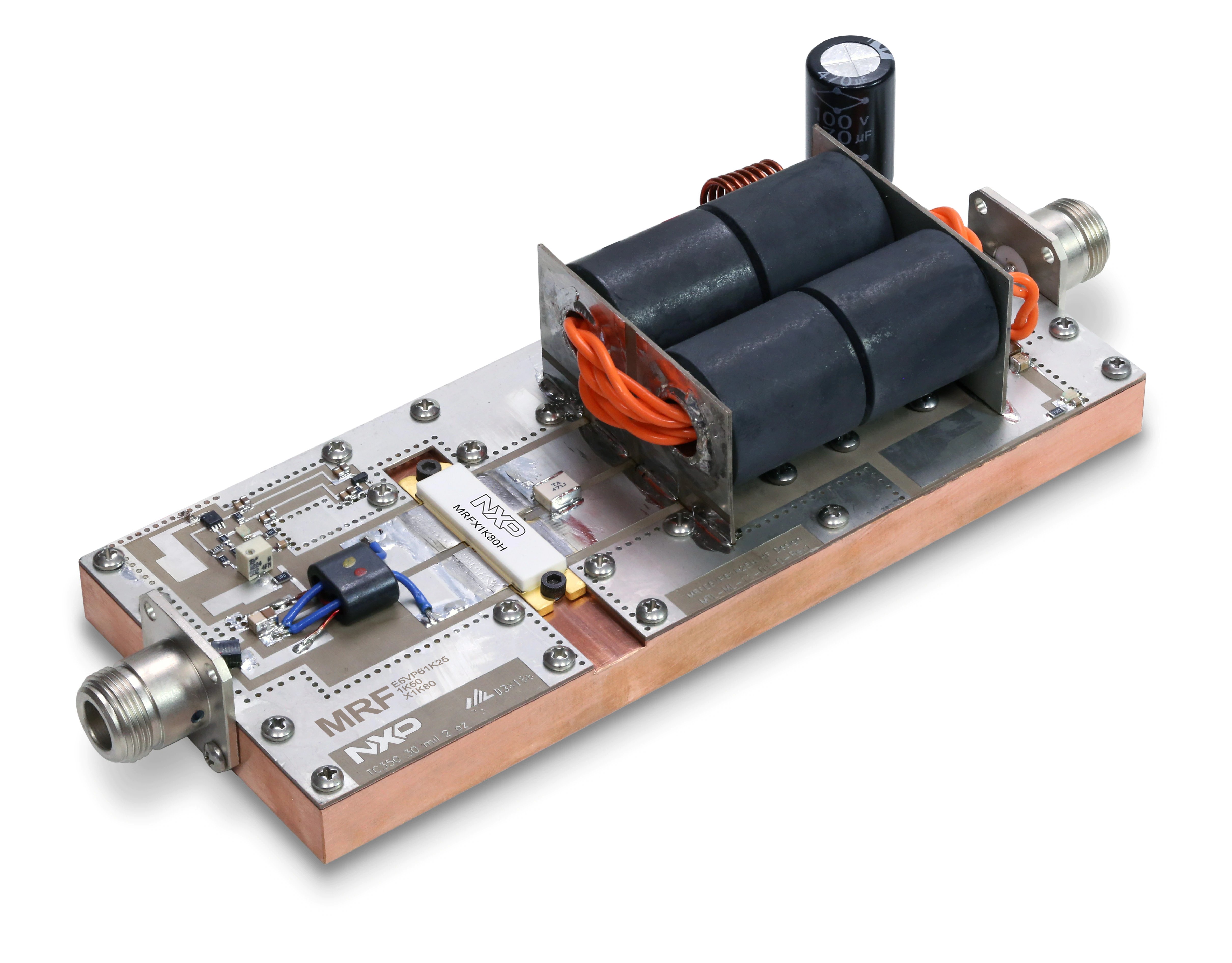

It's just 65 volts and minimum components. Not really rocket surgery let alone star wars.
I'll admit that any more than a quick read of the spec sheet will make your head hurt a bit but it's still a push - pull amp with design elements that have been with us for 40 years or more.
The big thing about the device family is the near 80% efficiency in a narrow band test fixture and no less that 72% in a well designed broad band application.
This is the 65 volt, mutated , ceramic packaged, dual device package, big brother to the MRF101 and MRF300 LDMOS devices.
