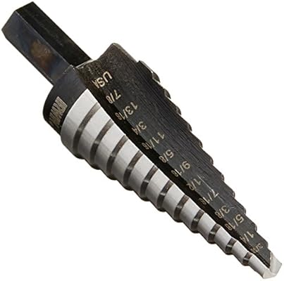

Given the damage a mag mount could do (it’s potential), the only pain with a proper antenna mount is a specialized drill bit.

This seems to be the cleanest way to make a perfect hole.
Kinda pricey at 35 bucks but totally worth it.
