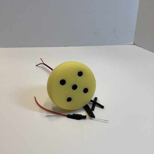

There we go, nice and neat with a small wire tie holding the trio together.
I scratched off the back of the traces and soldered directly to the board. I put a piece of foam rubber between the elements and the board.
Sounds great, stock with a little more bass.
So, is that all 4 mic elements in parallel?? Is this mod a "thing" in CB land? (I ask because I haven't seen this done before). I would have thought that doing this "might" do some funky stuff with audio phasing, and cancellations, etc..
I would be interested to know what one single element sounds like, in the new middle position. But at the end of the day if it works for you, it works! 73

As far as the shape of the sound goes, for two elements, one telecom and one Anytone, the sound would be half and half telecom/Anytone. The characteristics of both. Add more Anytone elements and that is the predominant sound. And vice, versa. With 3 telecom elements, and one Anytone, I can still tell the Anytone is doing something.
It is basically to tailor the sound, the way I am doing it. Others have used it to improve off center sensitivity.
Here is a listing for a 5 element electret conversion for a D104. This was my initial inspiration for putting elements in parallel.
