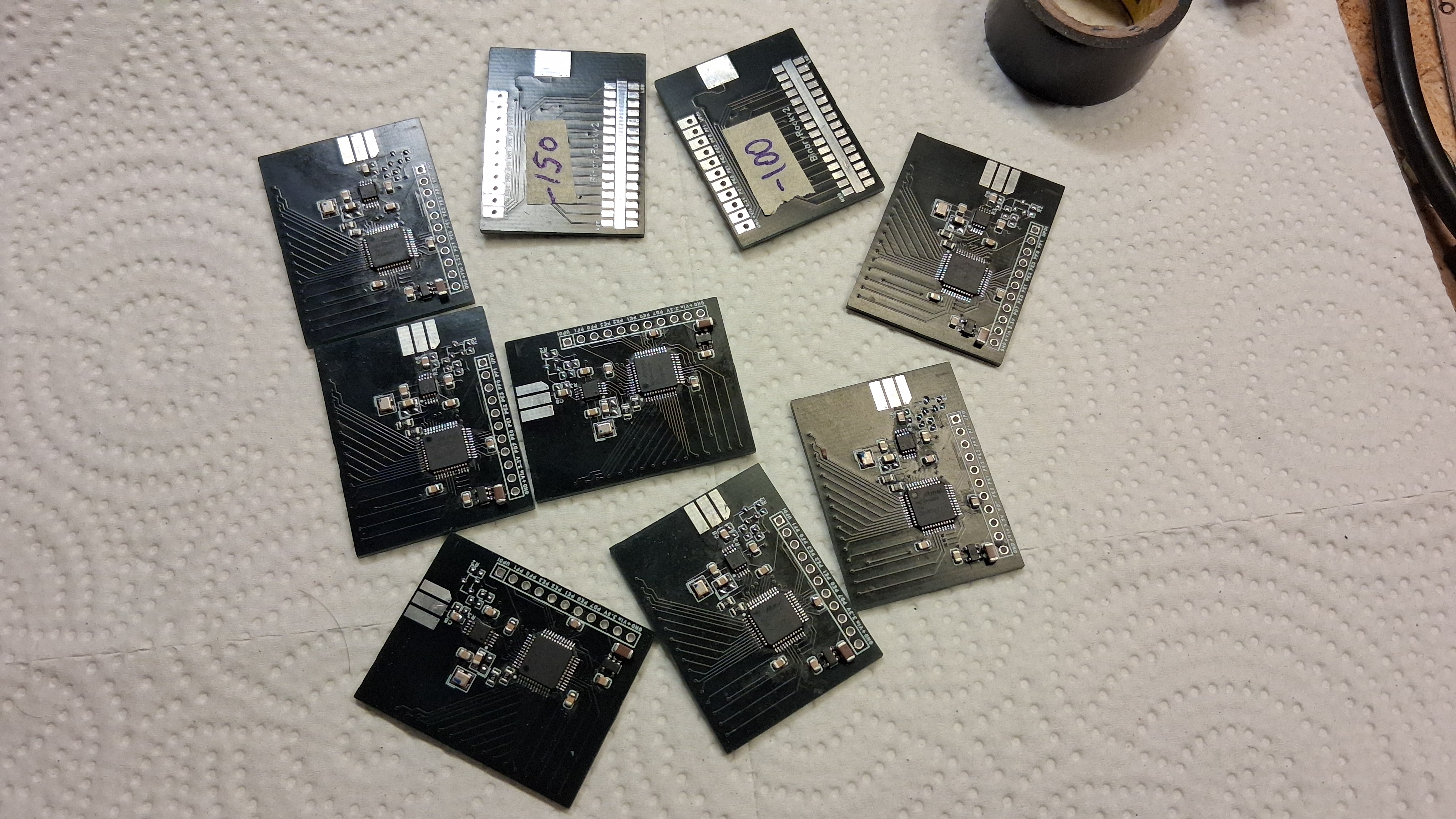

The first few are done but still missing buffer transistors and therefore haven't washed them. The faster transistors should arrive tomorrow and I hope to have some for sale by next week assuming I don't find any more bugs. These here already have a home lined up but I will make more next weekend.View attachment 77792

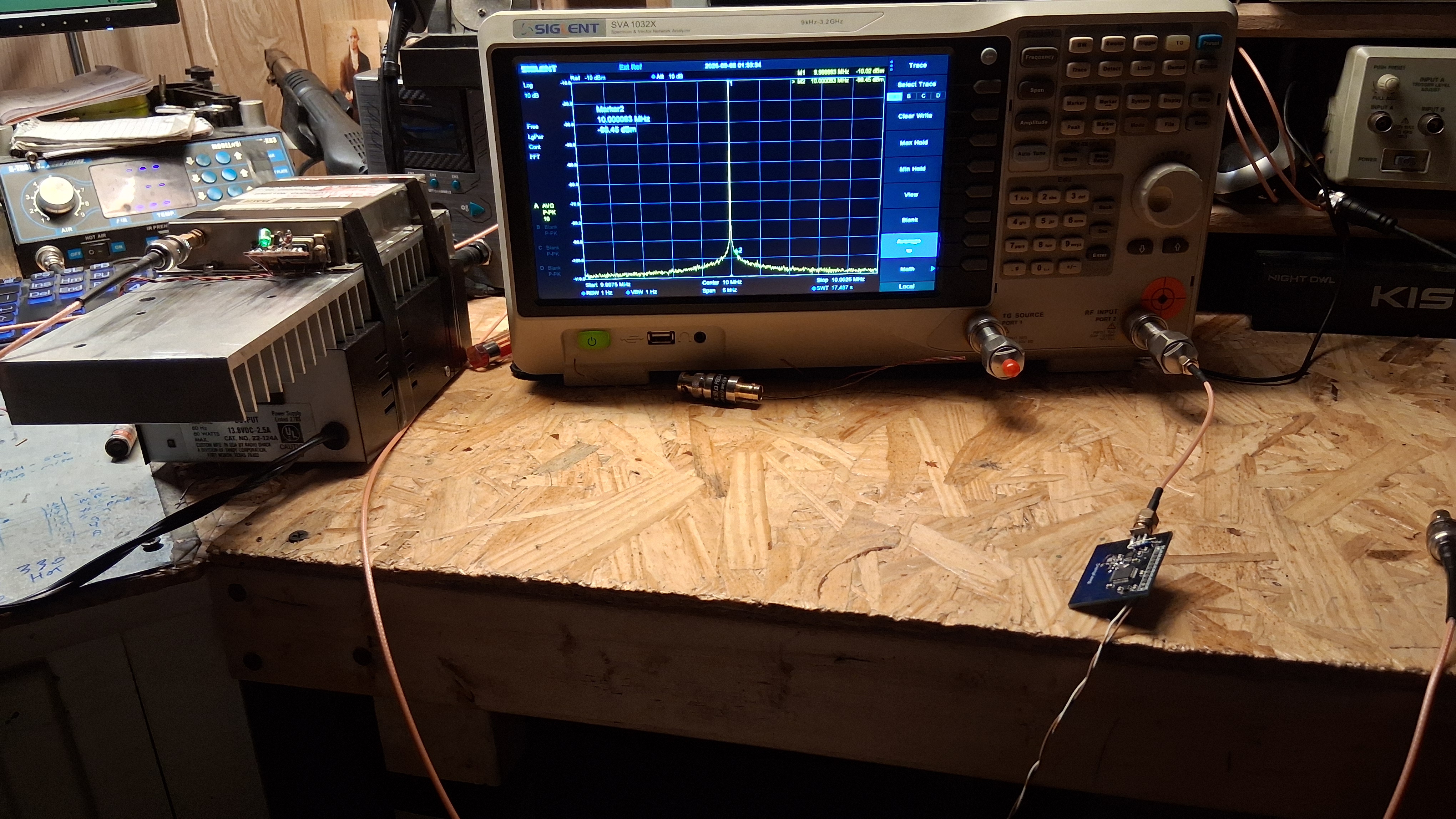

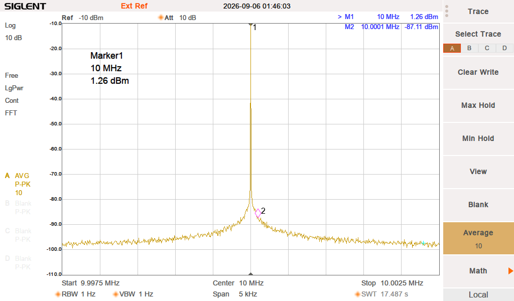

I connected a rubidium standard to the SA reference input and connected the reference output to the front input hoping that the rubidium source had a better phase noise than the SA in hopes to get an idea what the phase noise of the SA is.
I got this, 85.85dB down at +100Hz offset with RBW at 1Hz:

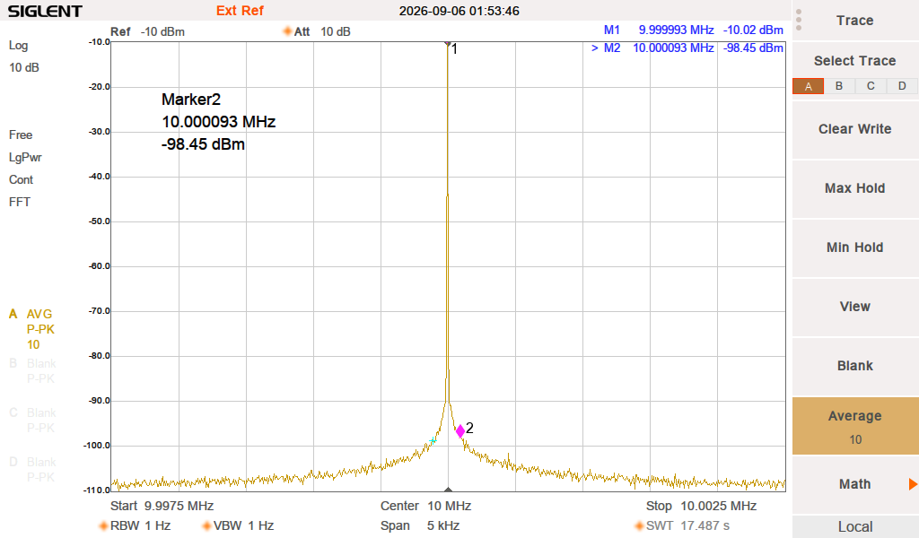

I then programmed the 5351 to output 10MHz and measured that. Since I did not calibrate the frequency yet, I simply offset the second marker by the same 100Hz and ran the averaging again. This time it showed 88.43dB. Somehow it is better than the rubidium source even though the rubidium was still being used as the reference.
Not sure how to interpret that, but if I adjust the voltage on the binaryrock board, the carrier peak and the second marker (and the entire noise floor) move in sync.
I don't know if the phase noise of the SA is limiting the measurement, but I am going to call this good enough. I did notice that the SMA on the rubidium was a tad loose when I took it all apart though, so maybe that should have been tightened better.

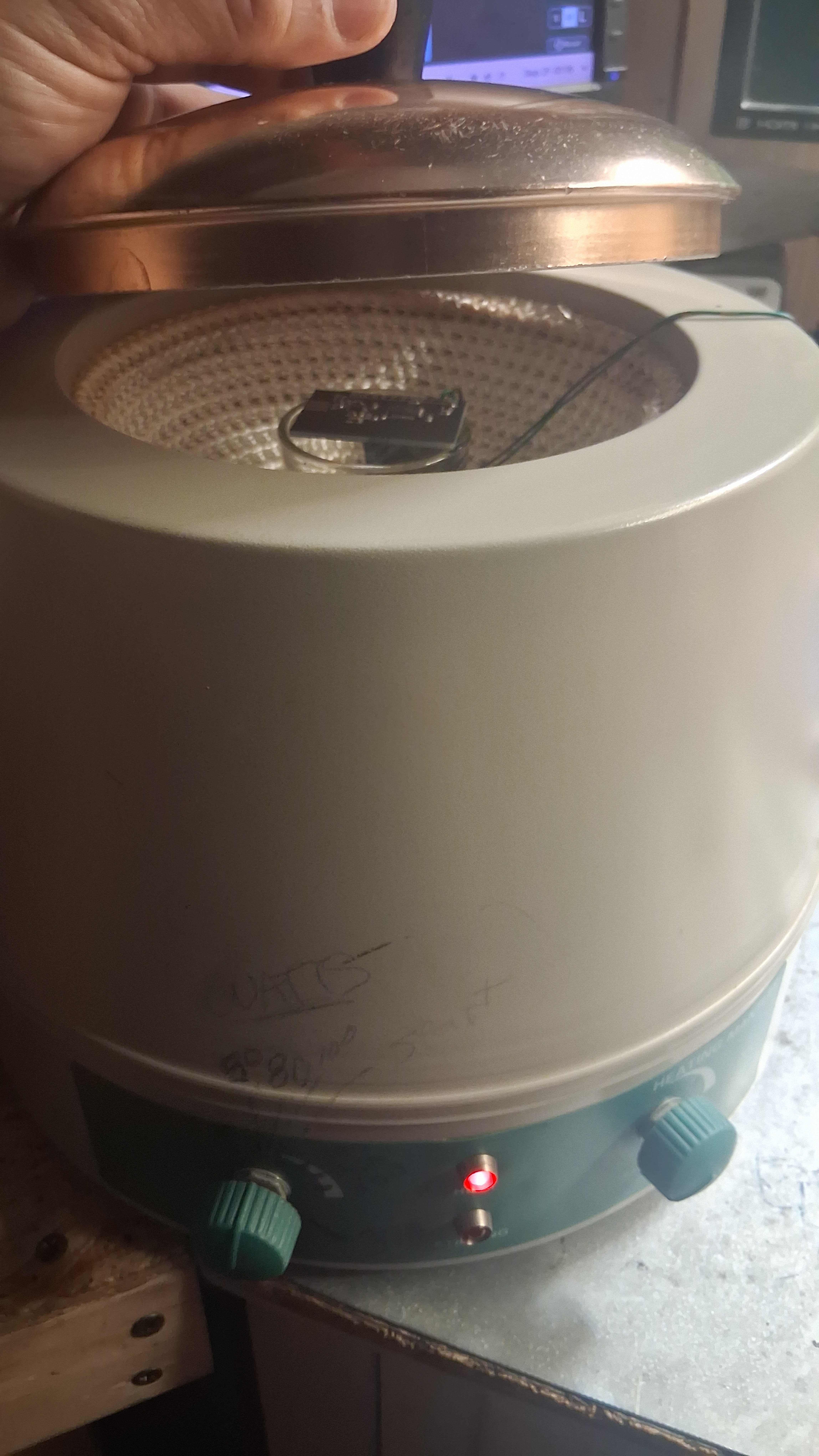

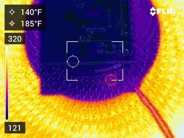

I will pull out the reflow preheater and see if I can test them at 150 degrees at 9v.
In the process of calibrating 10 more boards now.
Update: the preheater wouldn't go low enough so I had to improvise. Results coming soon
Results: At a board temp of 140F, the LDO is at the recommended maximum operating temperature of 185F. I think we are going to be ok inside a tube radio. Maybe mount it low and away from the tubes somewhere just to be safe,
