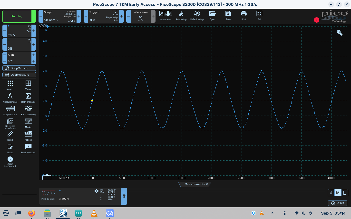

With a board sloppily fixed (pin 41 rerouted), I set it to 15MHz with 9.2v going in, I get this with a 1x probe:
and with 3.6v going in:
Voltage control seems to work good for setting output level. Hopefully this is the last round of ordering boards now. I have mastered every screw up possible along this journey but I finally have a decent signal coming out. I will use this bodged together board to work on code while the new boards are being stamped out.

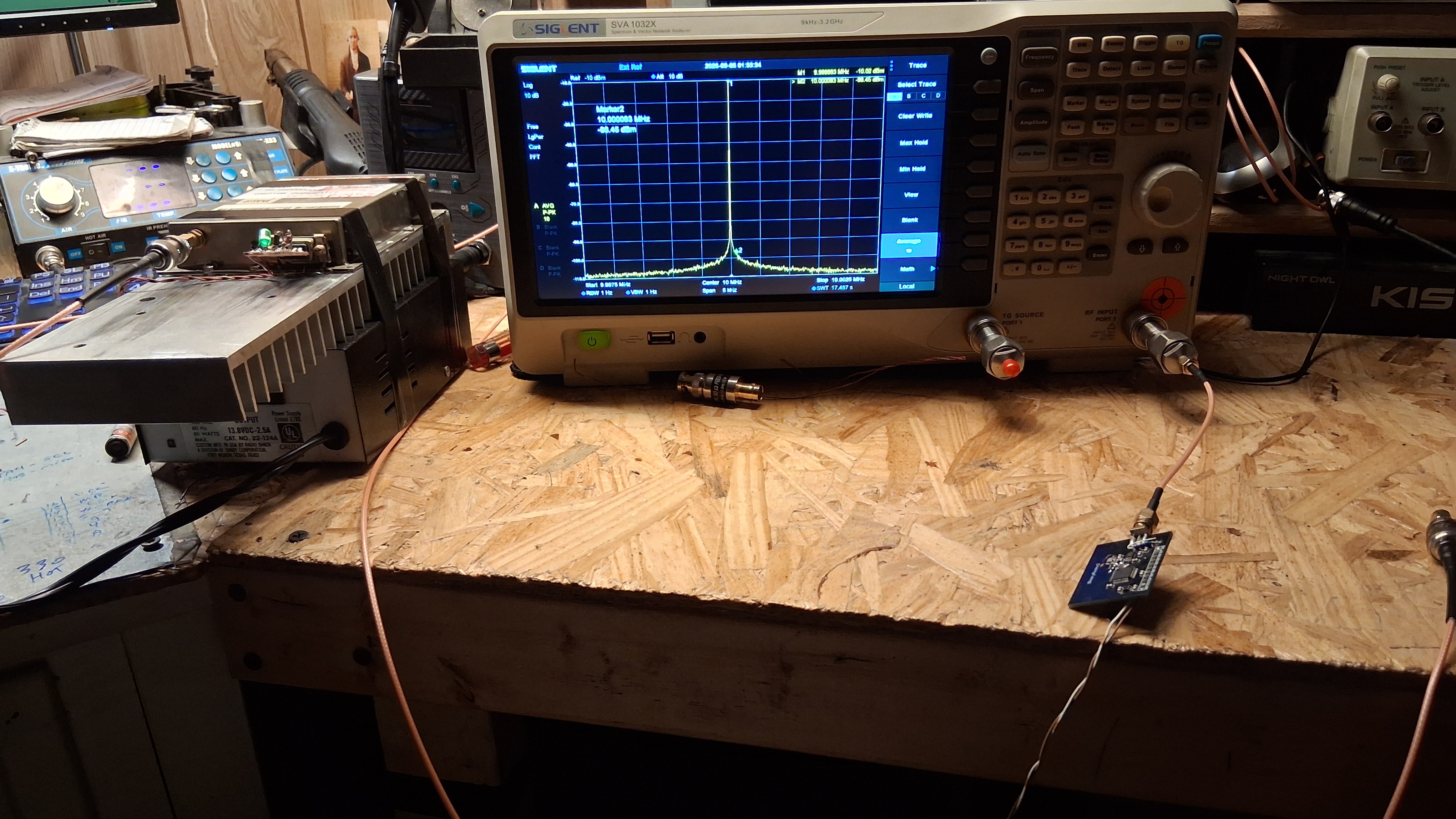

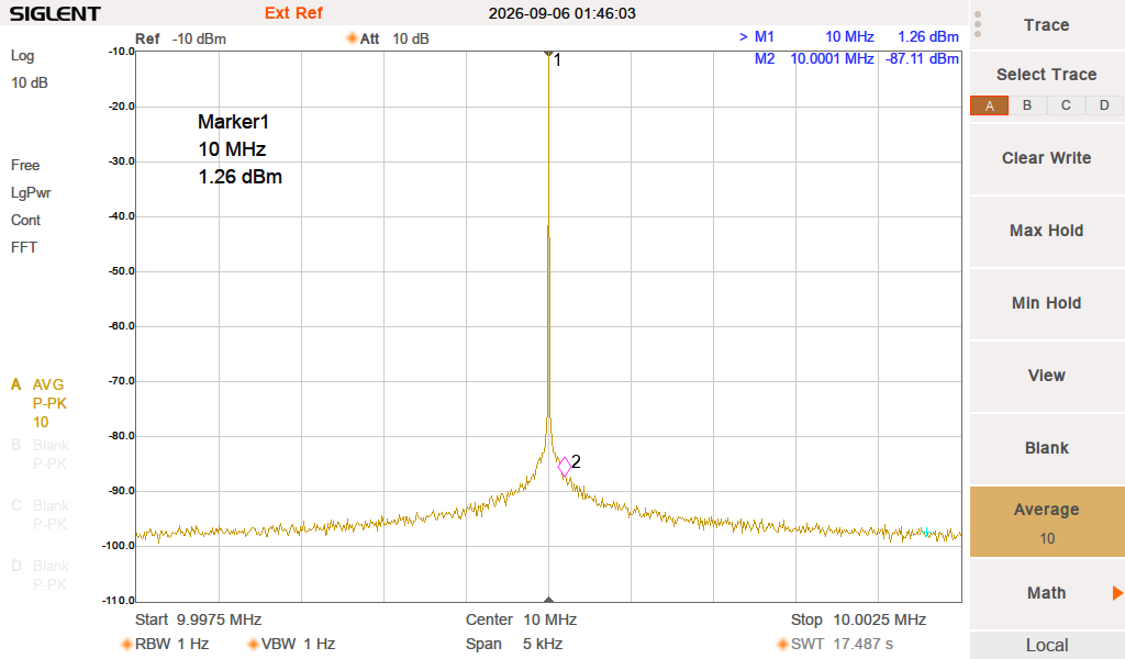

I connected a rubidium standard to the SA reference input and connected the reference output to the front input hoping that the rubidium source had a better phase noise than the SA in hopes to get an idea what the phase noise of the SA is.
I got this, 85.85dB down at +100Hz offset with RBW at 1Hz:

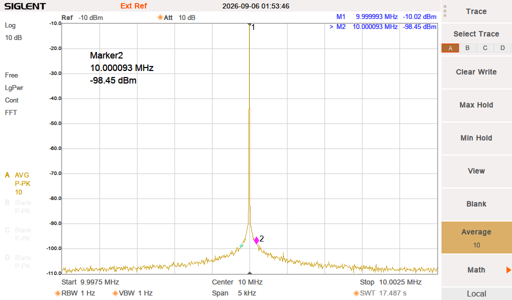

I then programmed the 5351 to output 10MHz and measured that. Since I did not calibrate the frequency yet, I simply offset the second marker by the same 100Hz and ran the averaging again. This time it showed 88.43dB. Somehow it is better than the rubidium source even though the rubidium was still being used as the reference.
Not sure how to interpret that, but if I adjust the voltage on the binaryrock board, the carrier peak and the second marker (and the entire noise floor) move in sync.
I don't know if the phase noise of the SA is limiting the measurement, but I am going to call this good enough. I did notice that the SMA on the rubidium was a tad loose when I took it all apart though, so maybe that should have been tightened better.

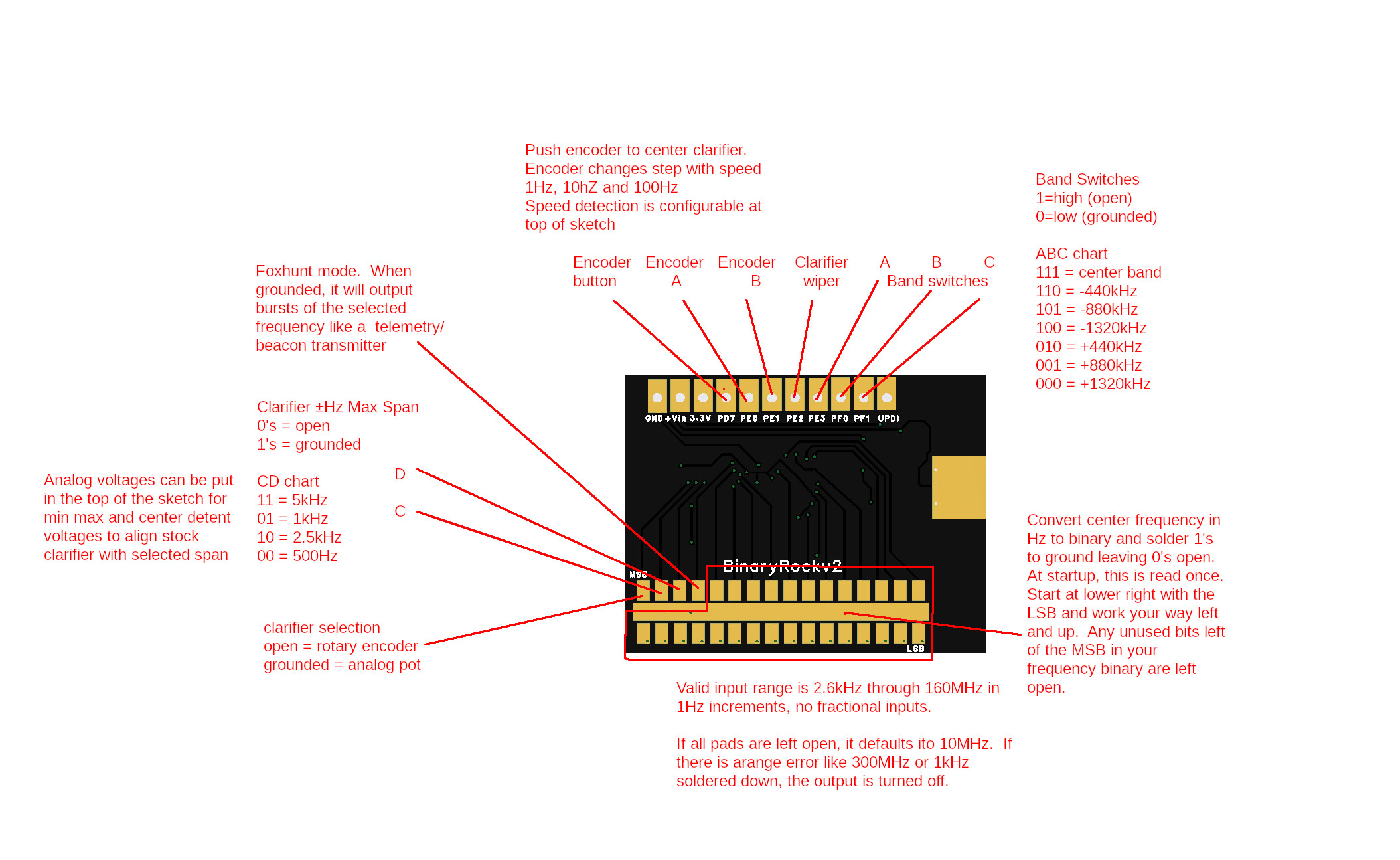

I ended up paying for grok and I am glad I did. I preloaded it with a ton of details and it output a pretty impressive code. This thing will allow analog and encoder clarifiers (pad 32 selects which), and the clarifier range will be set with pads 30 and 31 (5kHz, 2.5kHz, 1kHz or 500Hz clarifier range on both analog and encoder side). It also has a min, max and center voltage entry for mapping the analog clarifier. The encoder will have three speeds, 1Hz, 10Hz and 100Hz based on rotation speed (push to center). The sketch also determines the optimal settings for the synth based on the soldered frequency so hopefully there will be no pll resets using the clarifier. Since grok is hammering out working codes with every idea I feed it, I might have to ask it about FM too.
This is where I am at so far.
Unfortunately, I am short a few ground connections. Gonna have to splice ground in somewhere for encoder and band switches. Or solder em to the sma pads. Sorry. I do not recommend an SMA connector, should have did header holes to avoid unnecessary load capacitance from coax.
Reactions: Cable Guy
added the option for the foxhunt mode to identify with callsign and added entries for that, interval and WPM. Also added the option to use it as a CW practice transmitter. When in analog clarifier mode, the encoder inputs are unused. No more. One pin low turns the output off and the other low turns it back on. Now we can add a key.

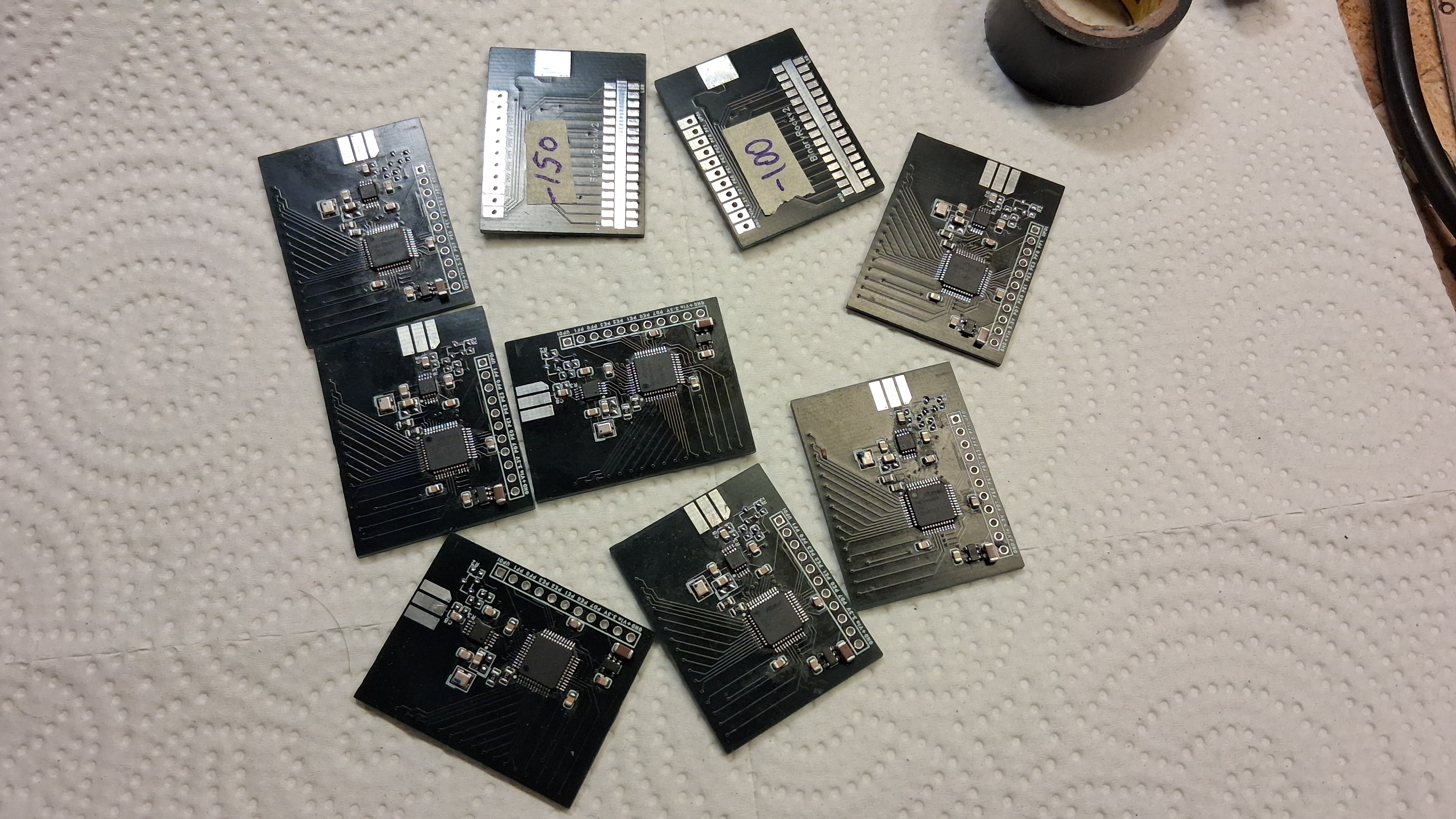

The first few are done but still missing buffer transistors and therefore haven't washed them. The faster transistors should arrive tomorrow and I hope to have some for sale by next week assuming I don't find any more bugs. These here already have a home lined up but I will make more next weekend.
