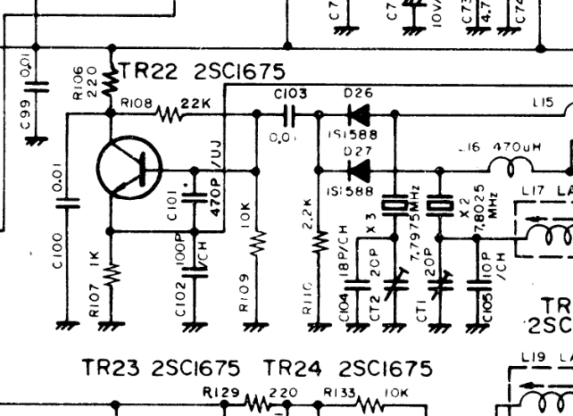

The third board is for 7.8MHz, and looking at the schematic, there is no tank/tuned circuit between this oscillator and the balanced modulator and mixer. It relies solely on the oscillators waveform being sinusoidal. Using the SA, I am able to see the offending signals coming from this oscillator.
I will be thinking of a way to add a tank to this circuit in the next couple days. There are a few ways to approach this, and I may try a couple different things over the next couple of mornings.

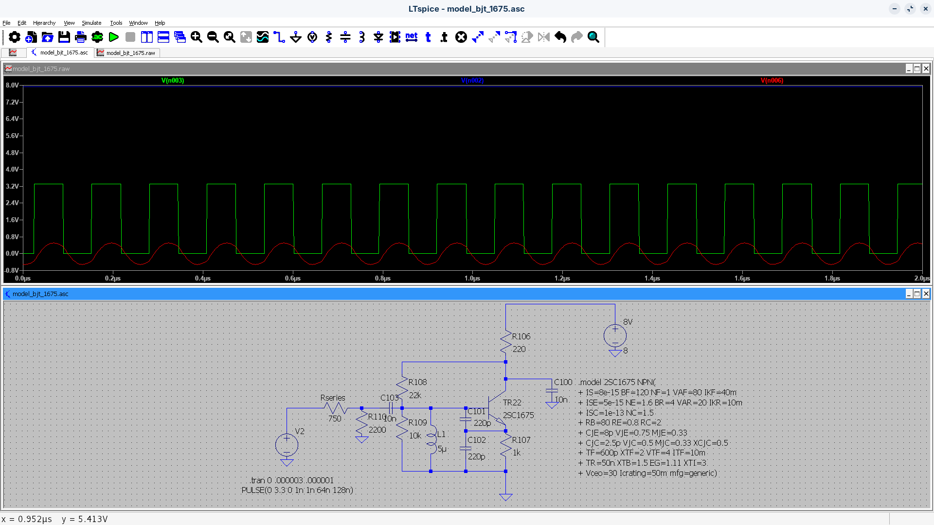

I stayed up til 5am anyhow and didn't even try it, but I think I have a plan. After getting a fairly believable model for the 1675 transistor, I played around in LTSpice and found that if I change two caps and add an inductor, I can get a really nice waveform. I don't know if 1.2vpk-pk is enough, but it was everywhere else.
Green is the clock signal and red is the emitter that feeds the radio. Maybe I will get lucky and one of those cans I made obsolete will have close to a 5uH winding.
Edit: I wonder if this will oscillate when in AM RX. The tank on the base is probably a bad idea, I hadn't considered when that oscillator is supposed to be turned off. in AM RX.
