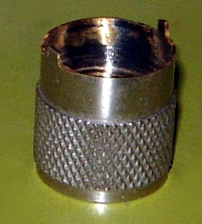

I fashioned one out of the screw on portion of a PL-259. It took me a couple hours using a Dremel cutting disk to make the tabs and a stone to remove the threads inside, but it works great and is one of my prize tools. The one I made only has 2 tabs, but it’s strong and will work with both 2 and 4 slot nuts.

This is a photo of what I made. It's not the greatest photo but should give you an idea of what I'm talking about. A PL-259 fits perfectly over the mic jack. In fact I believe it has the same thread size. The only problem is you need to grind out the threads on the PL-259 shell so it will slip over (not screw on) the mic jack and fit into the nut slots.
im going make one and put a handle on it i will show it when done.
