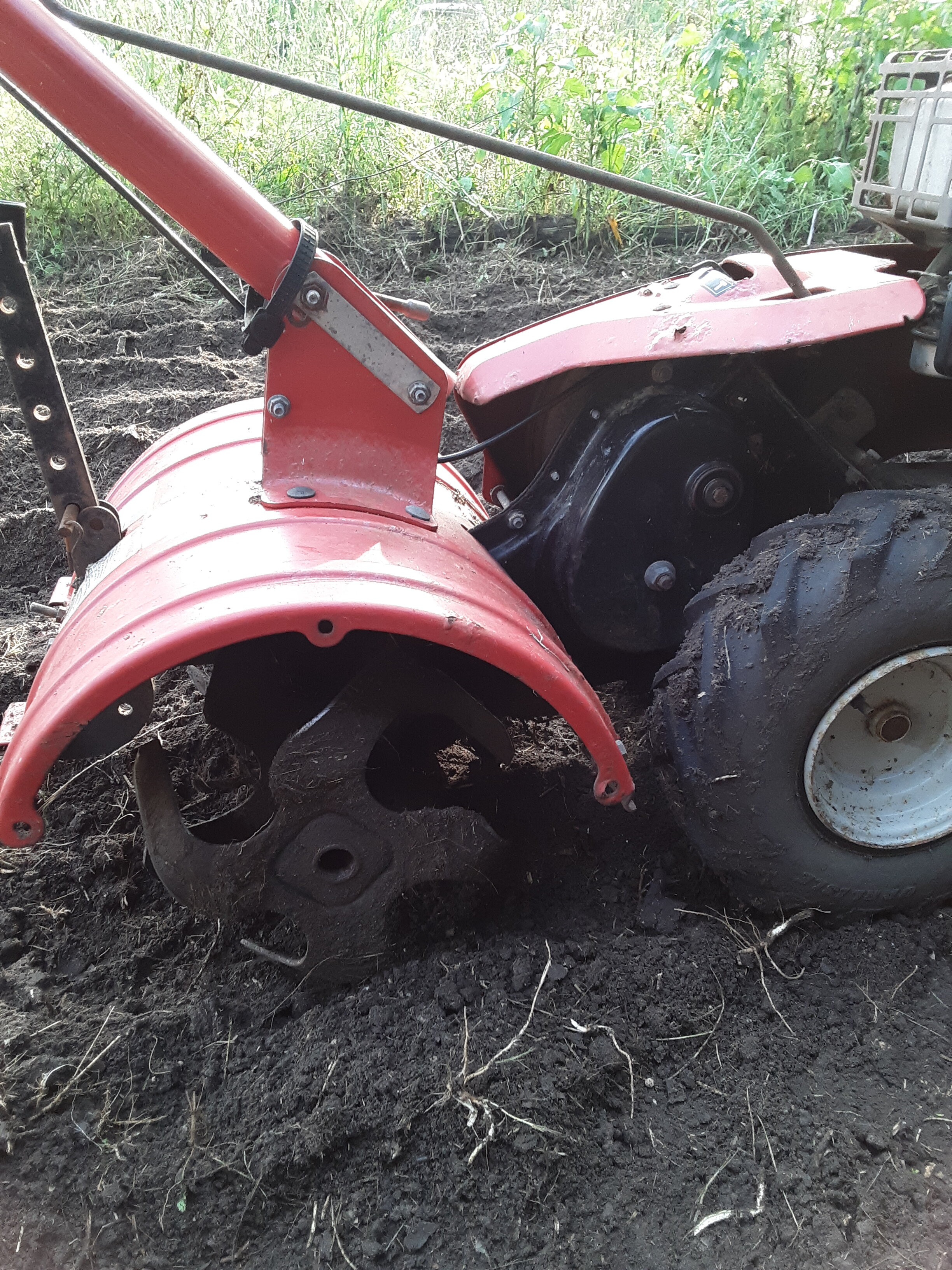

Got that Dangable Machine ( Baxter Black ) rolling, finally. Couple days to free up bearings at tines. Took some Blaster (the commercial form of Kroil) several soakings. Drilled hole in chain/ gear case, yes (Redneck Engineering), but cost effective. Poured about 3 pints Rotella in. Ha, Rotella for the Rototill. Massaged it by turning tines with an 1-1/2 dia. pipe. Let sit, soak cycle. Tap tines with 3 lb. beater. Alot. Let sit. Tilt tiller back on incline, use your imagination, for a day. Let soak. Patience son. Let Rome burn. Beat on tines again till free enough to turn by hand. Hoorah! Redbeard Engineering, if it don't fit.....force it. Seal 1/4" hole with rtv. Fire that Mutha up. Tines are roll'n. Success. Change oil, cause God only knows when Kav changed it last. By his own admission, it must have been 16 years ago when he bought it. Rotella again for Rotatill. Here we go up into the wild blue yonder..........

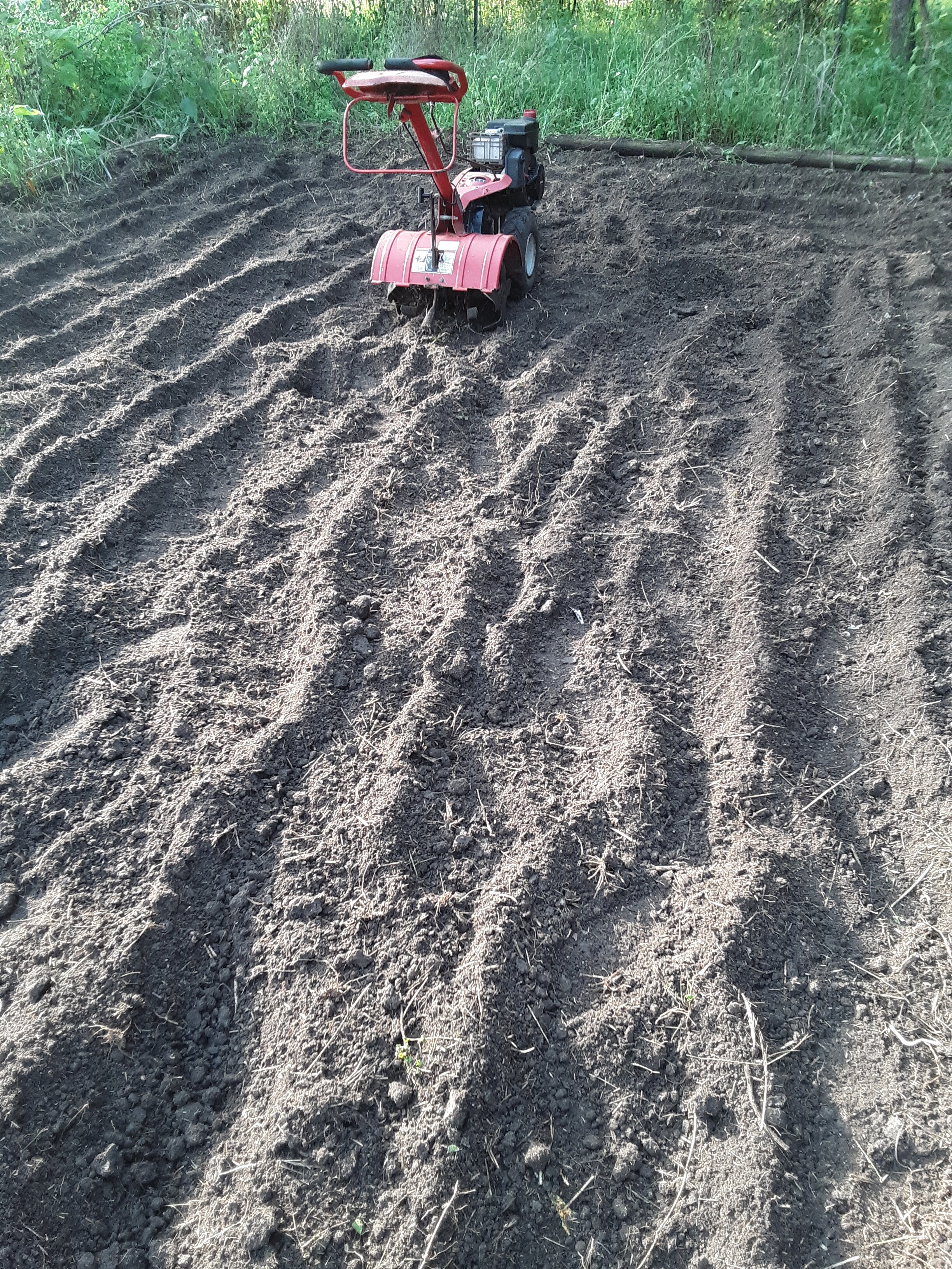

Here is 2 hrs ground break, only maybe 3" deep. Beer thirty. Chicken feed em up time. Contemplating renting a Ditch Witch and bust some Black Gumbo Ass. Go 2-3 foot deep. This Black Gumbo will be rock hard after setting up winter months if not busted up with dynamite for winter garden. Trying to scrape this crap off boots, best done with a hoe, wire scratch, and sweeper nozzle on garden hose.
