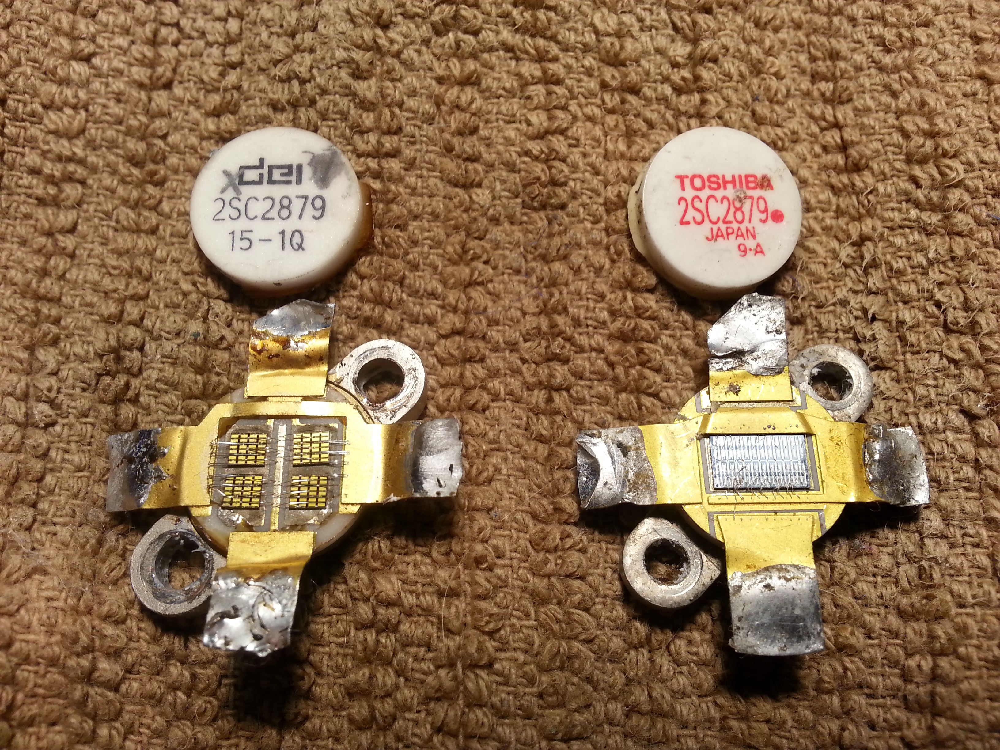

Just as I suspected. Quite a difference when you pop the hood on these two 2879's. Not too hard to see absolutely zero effort was made to simulate a 2SC2879. Just look on the shelf for some existing bipolar transistor that could be re-stamped as a counterfeit 2879 and market it. It's not that I hold China responsible for taking advantage of the opportunity our incompetence has offered them. It's that many Chinese companies are very eager to lie and cheat their way into the market place. That creates an unfair advantage that allows them to force companies like ASI out of the marketplace. Preventing us from being able to purchase a real 2879 replacement today.

I own both a TS Sweet Sixteen with Toshiba transistors and a newer unit with the DEI transistors. Running both at 14 vdc there's about a 150 watt difference in output with the same drive level into a 50 ohm dummy load. DEI's draw less current. Running the collector voltage to 15.5 vdc the difference in output is about the same. Conclusion the DEI's don't have the same gain obviously, but continue to amplify fairly linear.
Didn't see any real RFI as a result of the DEI's nearing saturation. Toshiba's are better but will still get dirty when pushed. You want more head room then buy the Toshibas. The DEI's have their limitations but appear to perform as specified. I've been running a DEI based TS SS for more than a year on a 300 amp supply set at 15vdc. It's my base amp and have had it up to 16 vdc and it still going strong. Guess I got lucky. Funny thing is I just bought a new TS DX1600X and it too handles the increased collector voltage just fine too. Seeing 1400 watts output so I'm happy.

I was actually thinking DEI deserves a lot more bad press. Like as much as they can get for taking the best bipolar transistor number and deceptively placing it on an entirely different and substandard part. Unless quality control is non existent (probably) I wouldn't expect gain to be the trouble. It's the breakdown voltage of the internal junctions and the current handling ability that tells me this ain't no 2SC2879. It's as good as Bofang placing the Icom name on a $39 HT.
Having said that, I admit there is no other part being manufactured today that closely resembles the real 2SC2879. Just don't treat us like an idiots and place a Porsche 928 turbo emblem on a Volkswagen bug while assuring us it's the same thing. If DEI was close to being honest, they would have ripped off the MRF-492 number for use on this part rather than 2SC2879.
I would like to see less opinion and more facts. Just rip the cap off of a bad DEI (should be easy to find) and compare the size of the silicon junction inside the transistor to the Toshiba. Since both parts are rated for 12 volt operation, the only way to handle similar power is to support the same current. That is determined entirely on how wide the internal junction is and how many fine gold wires are installed to carry the current.
