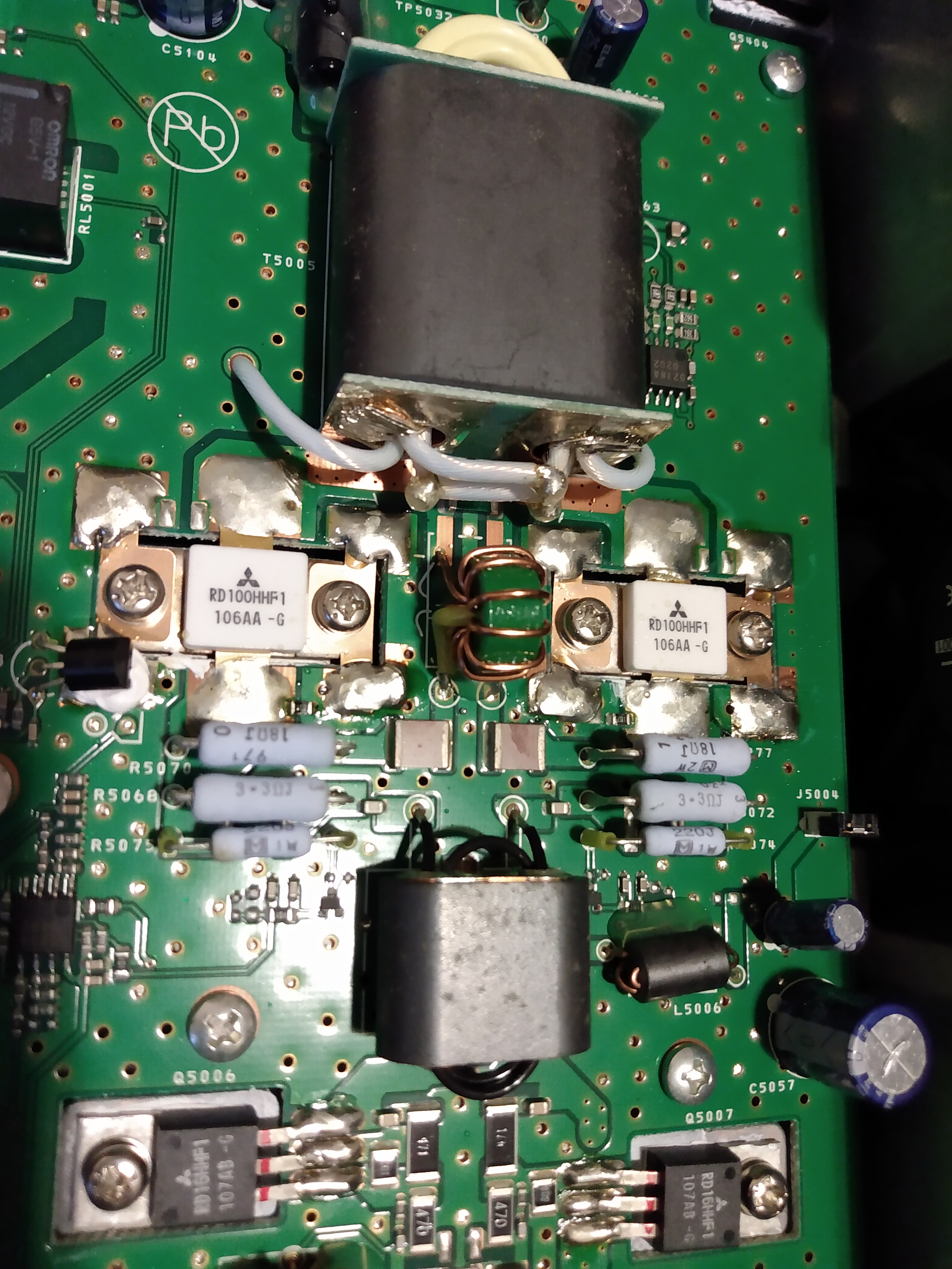

Just got an FT- 950 in to convert the AM low level IF modulation, to modulate a higher level RF stage. I figured I'd post a pic of its RD100HHF1 1.8 to 54 MHz. PA stage. Looks like the output transformer is four turns of coax on the secondary. The front side has been cut so the braids are connected back to the brass primary and the center conductors were just soldered back together. The input transformer is interesting. Primary is one turn of brass tubing and the secondary is two turns feeding the gates. Keep in mind the driver output is from a balanced push pull stage...

Just got an FT- 950 in to convert the AM low level IF modulation, to modulate a higher level RF stage. I figured I'd post a pic of its RD100HHF1 1.8 to 54 MHz. PA stage. Looks like the output transformer is four turns of coax on the secondary. The front side has been cut so the braids are connected back to the brass primary and the center conductors were just soldered back together. The input transformer is interesting. Primary is one turn of brass tubing and the secondary is two turns feeding the gates. Keep in mind the driver output is from a balanced push pull stage... View attachment 46264

The "C" version is RoHS compliant. When you have a choice, you want to avoid compliance here since it eliminates the Beo ceramic which has better thermal conductance.
The 950 is more difficult to mod than other HF rigs because just about every part of the audio circuitry, gets replaced with a custom modulator PC board.
