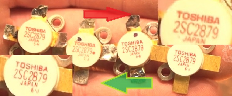

This Is The 2SC2789 World - You're Just Living In It...
By the way did you notice - Toshiba is Bold Font, Proportional spaced, not mono-space font - BBI did a great job in pointing that out...
If you don't see these colors on your TV set...
Note, TOSHIBA is not just a word, it's a brand...
That TOSHIBA design is a LOGO...​

I think the point is that the days of quality Japanese transistors is over and all thats left are cheap knockoffs and no one knows how many amps are now full of fake Toshiba's.
That being said at least the HG pills are a better quality knockoff than the fake Toshiba's but I still won't pay for the hg what I was paying for toshiba.
