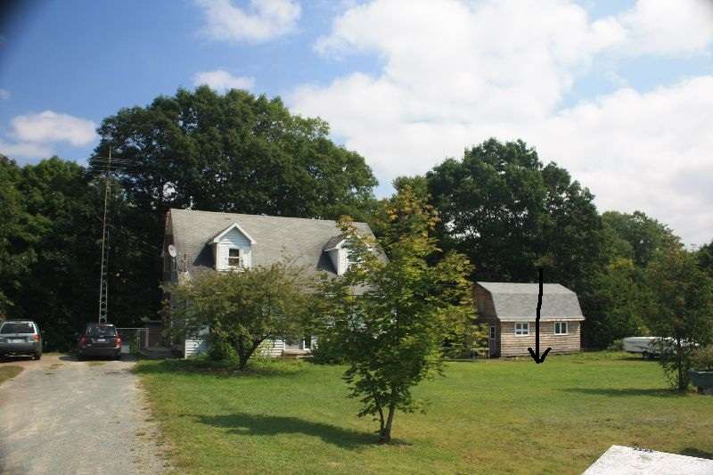

Here is a view of the old existing tower and location as well as the new location marked with a black arrow. The tower will be located just back from the front edge of the house about 43 feet from the house. This places it far enough from the tree line so as to never have to worry about tree growth as well as far enough from things that may interfere with raising and lowering the antennas.The old tower is 40 feet high and the new one is 64 feet.

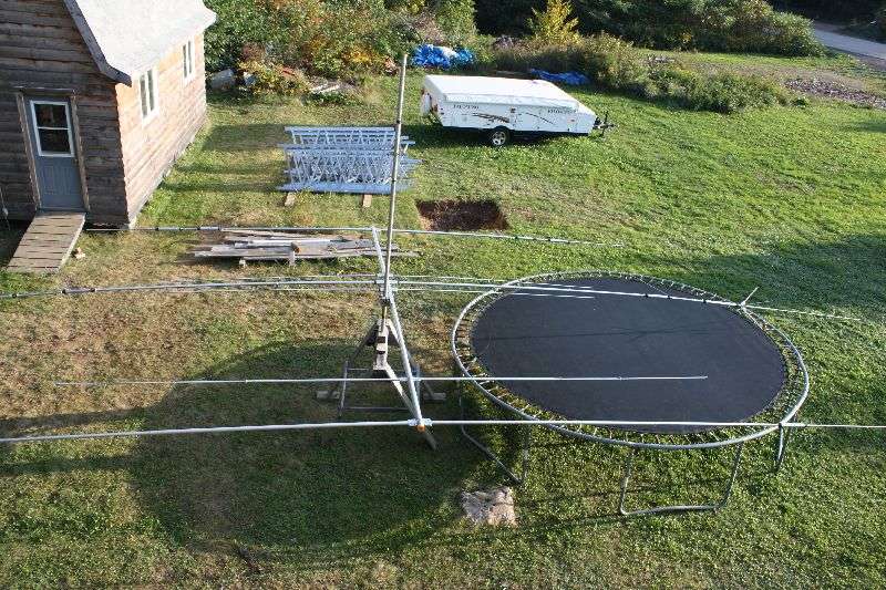

Here is the Explorer-14 I just finished the other day.It has the 40m add on kit installed. For size reference, the trampoline is 14 feet diameter.

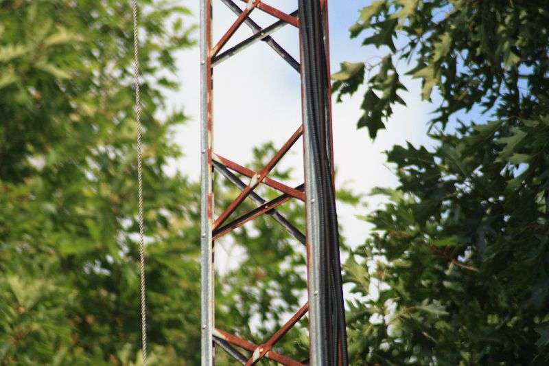

Here you can see one of the reasons I wanted a new tower. Rust is not a tower's best friend. The old Delhi served me well over the last 30 years and it was used when I got it. The new Trylon should outlast me.
