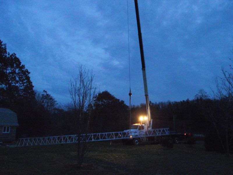

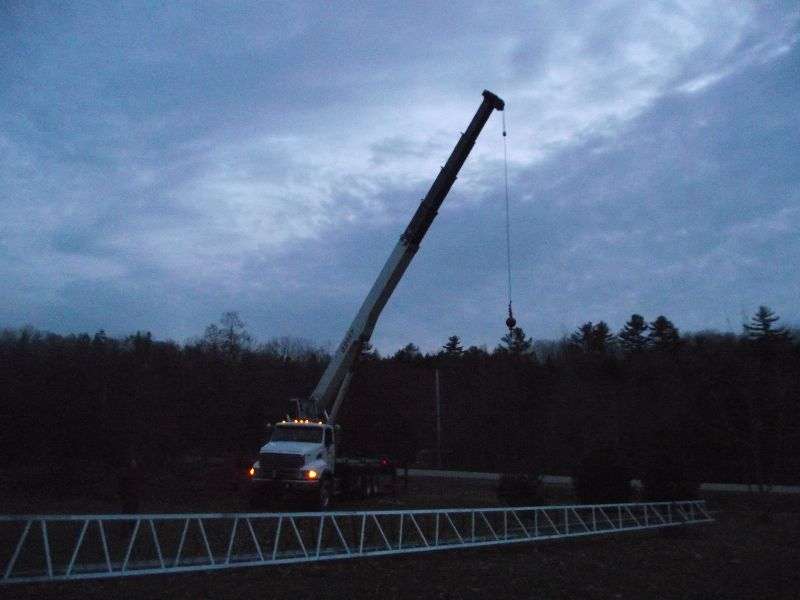

Well the tower is finally up!! The crane arrived a bit late due to a previous job taking longer than expected but at least it arrived. It showed up at about 4:45pm and it was a race to get things done before dark. Sorry for the quality of some of the images. It was getting dark, the wife was taking the pictures with her camera and her camera does not take as good a picture especially in low light as mine does.

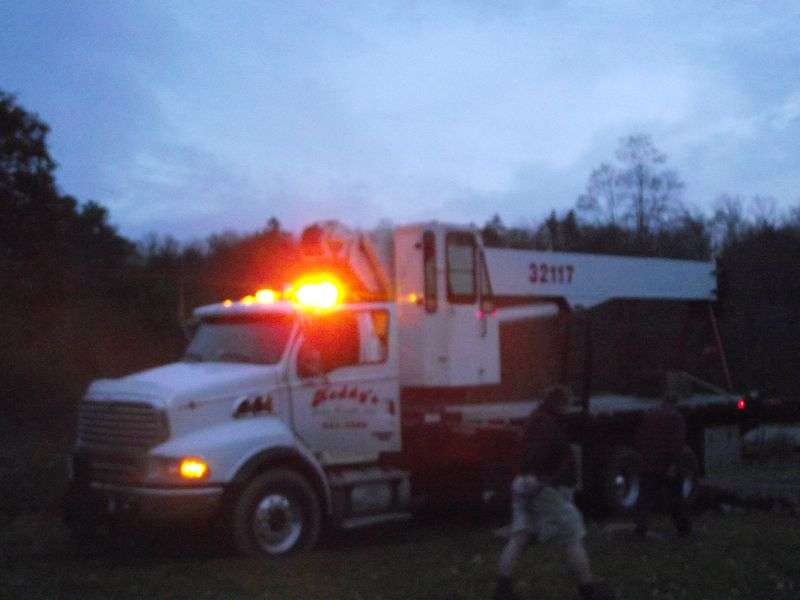

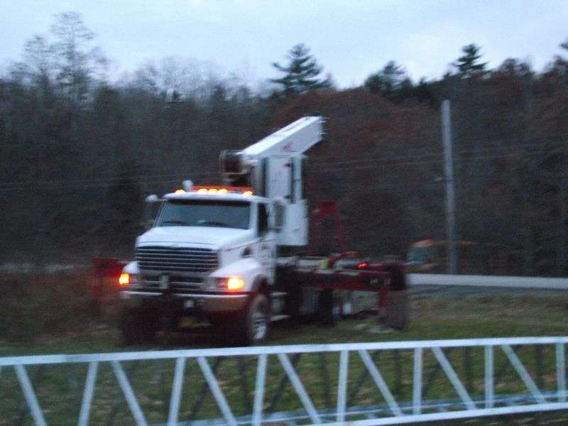

The crane arrives.

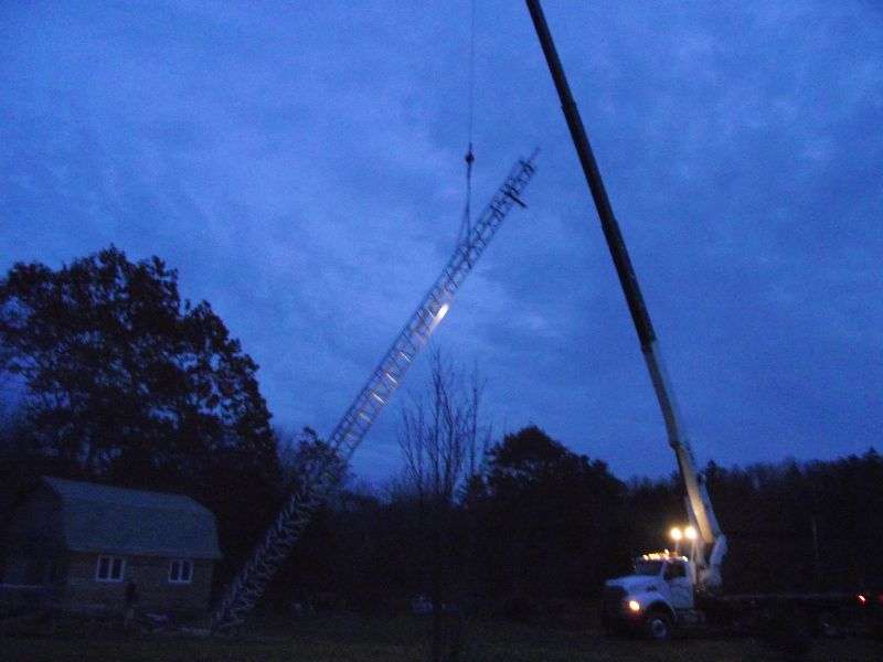

Getting ready to lift. We attached two slings at about the 55 foot level.

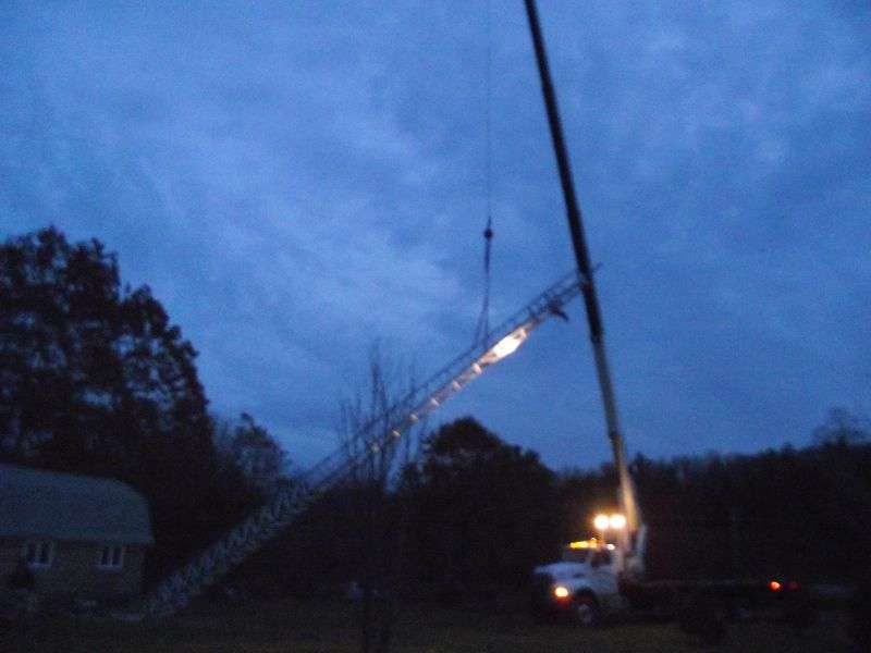

Testing the height versus reach limits. Maximum boom height at this reach was 80 feet before the limit was exceeded.
Starting to lift.

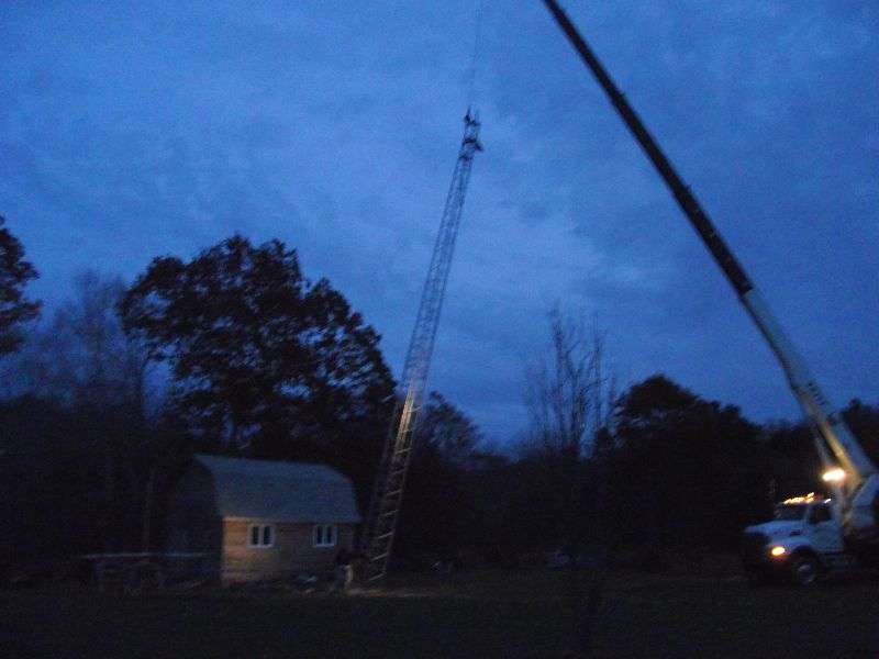

Up it goes.

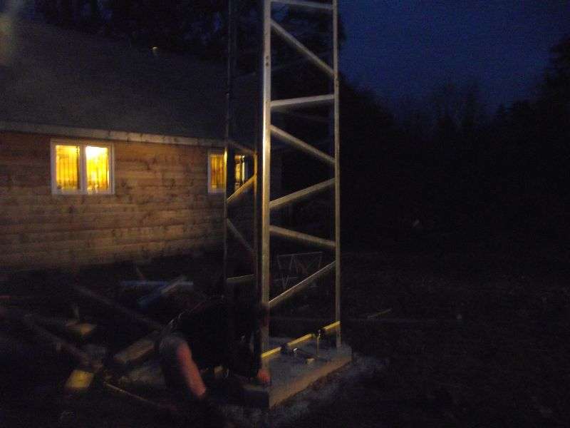

Putting in the first bolts.

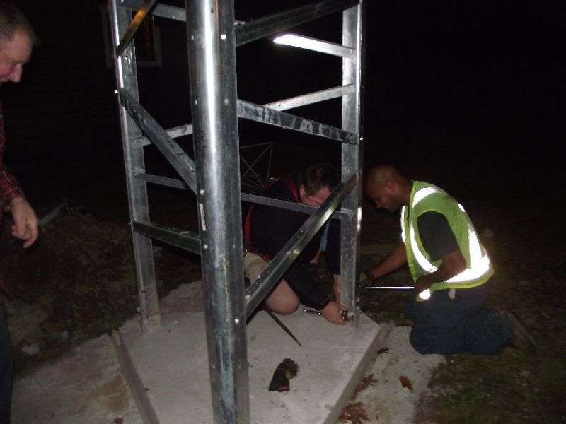

My father on the extreme left, me in the middle, and the crane operator on the right installing the bolts. There are four on each leg.

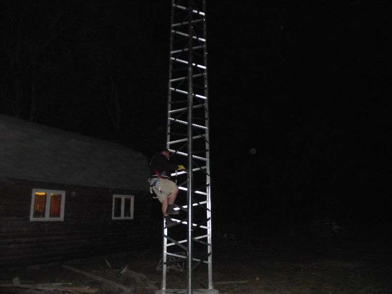

Somebody had to go up and unhook the slings and lift cable.That somebody was me.
Still going up.
I was just up to the 55 foot level and the lowest antenna will be about another 10 feet above that while the 6m beam will be at nearly 75 feet. What I could see from 55 feet was a world of difference from what I can see at ground level. It looks as if I will finally be above the surrounding terrain in all directions. I'll get more pix tomorrow in daylight and some from the top whenever I get that far up.

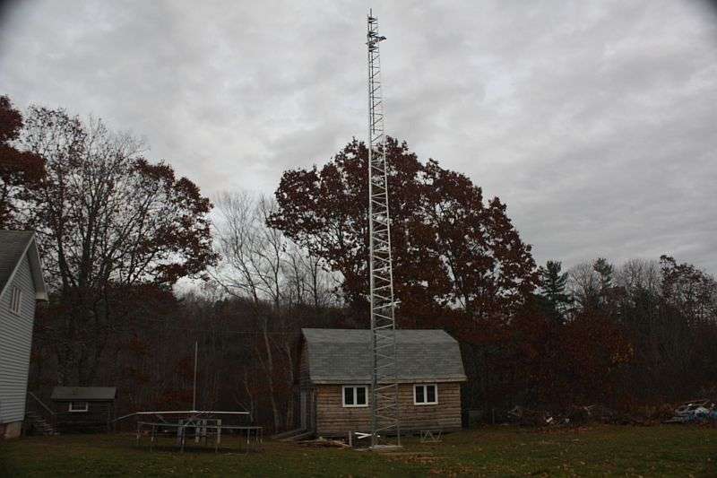

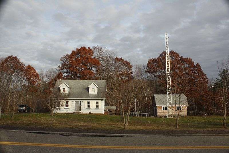

A few more pix of the tower now that daylight is upon us.

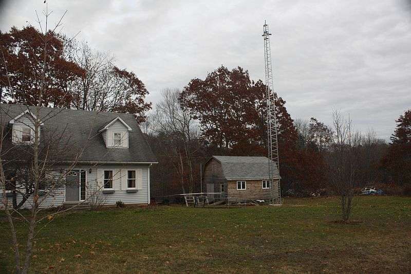

Overall view from the driveway.
Straight on from the road.

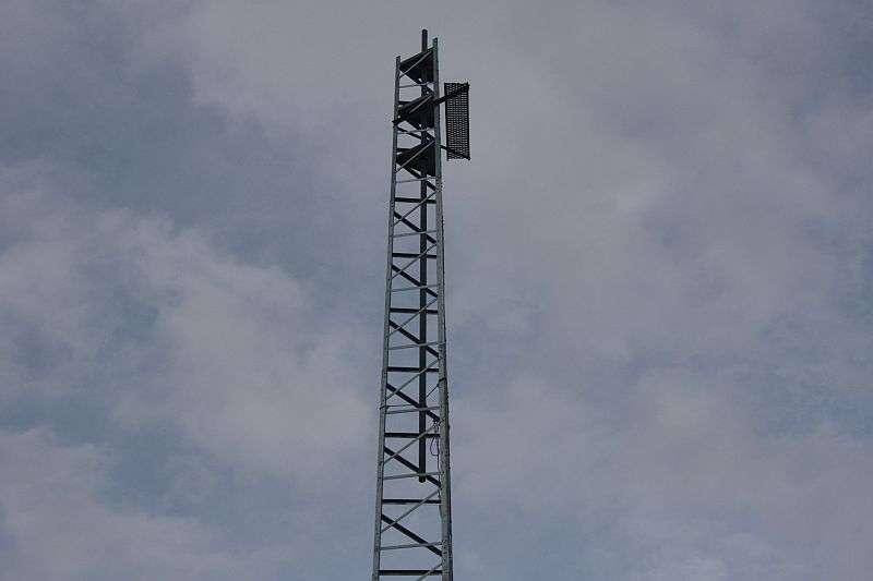

Close up shot of the top showing work platform at about 57 feet. Also the 21 foot mast fully retracted into the tower. It will be jacked up as antennas are added and will eventually be all the way up sitting in the rotator mounted on the bottom shelf. This will put the 2m antenna at about 77 feet, the 6m antenna at about 72 feet, the 12/17m yagi at 67 feet and the 10,15,20,40m beam at 62 feet right at the top. The overall height of the 64 foot tower is really only 61 feet due to overlapping of sections.
Overall shot from across the road.
