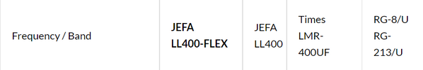

dB loss / 100'
You can certainly do worse than RG-213; namely RG-8X or 58 (350-400W). Though with Velocity Factor there is little or no difference. The lack of a foil 2ndary shield? Probably attributes to the 0.36dB loss increase?

I have included a JefaTech Low Loss 400 spec sheet from 2005 and a Times Microwave LMR-400 spec sheet from 2007 for comparison.
