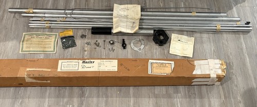

I think I see a gross error in the Manual.
Click on Jeff's attached image from his post #47 above, Hover and left click on the Attachment below.
You can also enlarge the Jeff's image by clicking the (+) and undo (-).
Notice the image above on the right...shows the insulated support clamp (#17) is attached to the short side of the trombone tuner section and instruction details show it is attached to the long side.
Check out Jeff's image above for the tuner section. The trombone tuner on the right side notes the 2 tuning sections of 1/8" tubing wires (#10-Small side & #15-Large side).

Can you share some pictures of it?
I have a Mosley TA-53M & there are hundreds if not thousands of pictures of it on the world wide web. Mosley I would think has pictures of the vertical mentioned in this post. They have been in business right here in the USA for over 78 years. You can't stay around that long building JUNK because your reputation will run you out of business.

No it doesn’t, just drawings.
