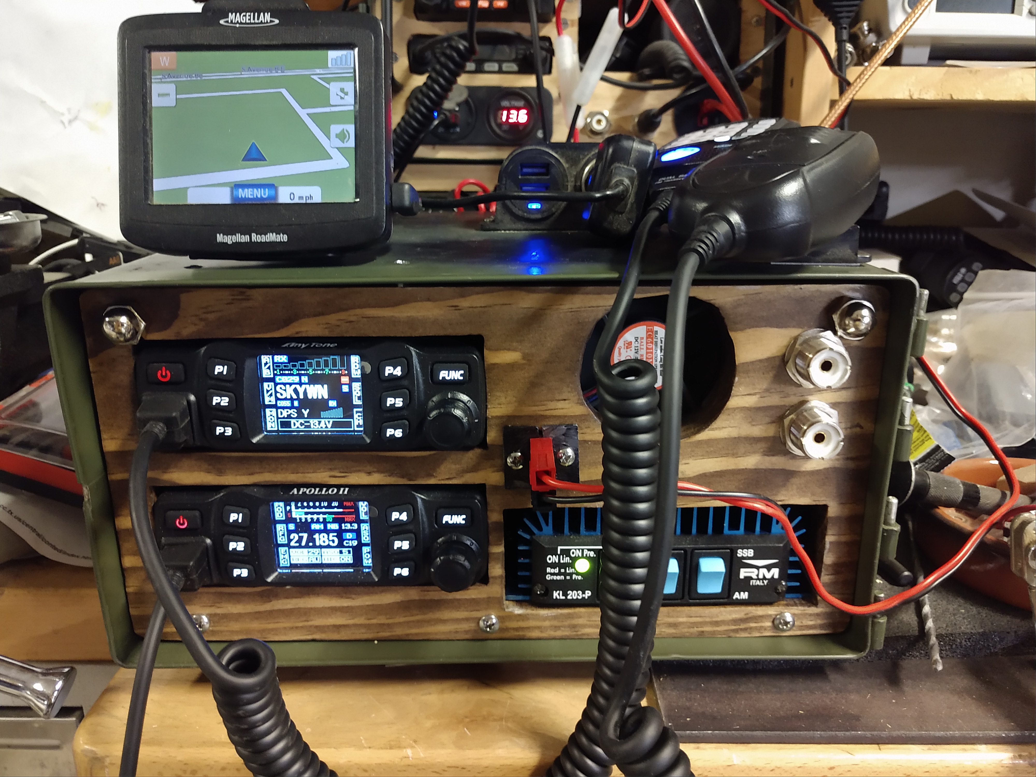

Welcome to the Forum Little ! (y) I used & old Plano Box Rack that held 4 box's ( trays ) , w/ box's removed , I installed my Old Cobra 140GTL , 250 King Bee Amp , Meter , Hand held Scanner ( slid on the side ) Old RS Spkr mounted on top , plus room to keep a Stock Mic in case I need it . I like it , it has a handle , easy to carry in/out w/ Anderson Connectors . But just recently had to reinforce it to make up for the cutting I did on it . Just a thought , worked for me . Stay Healthy & Safe ! 73 & God Bless ! Leo

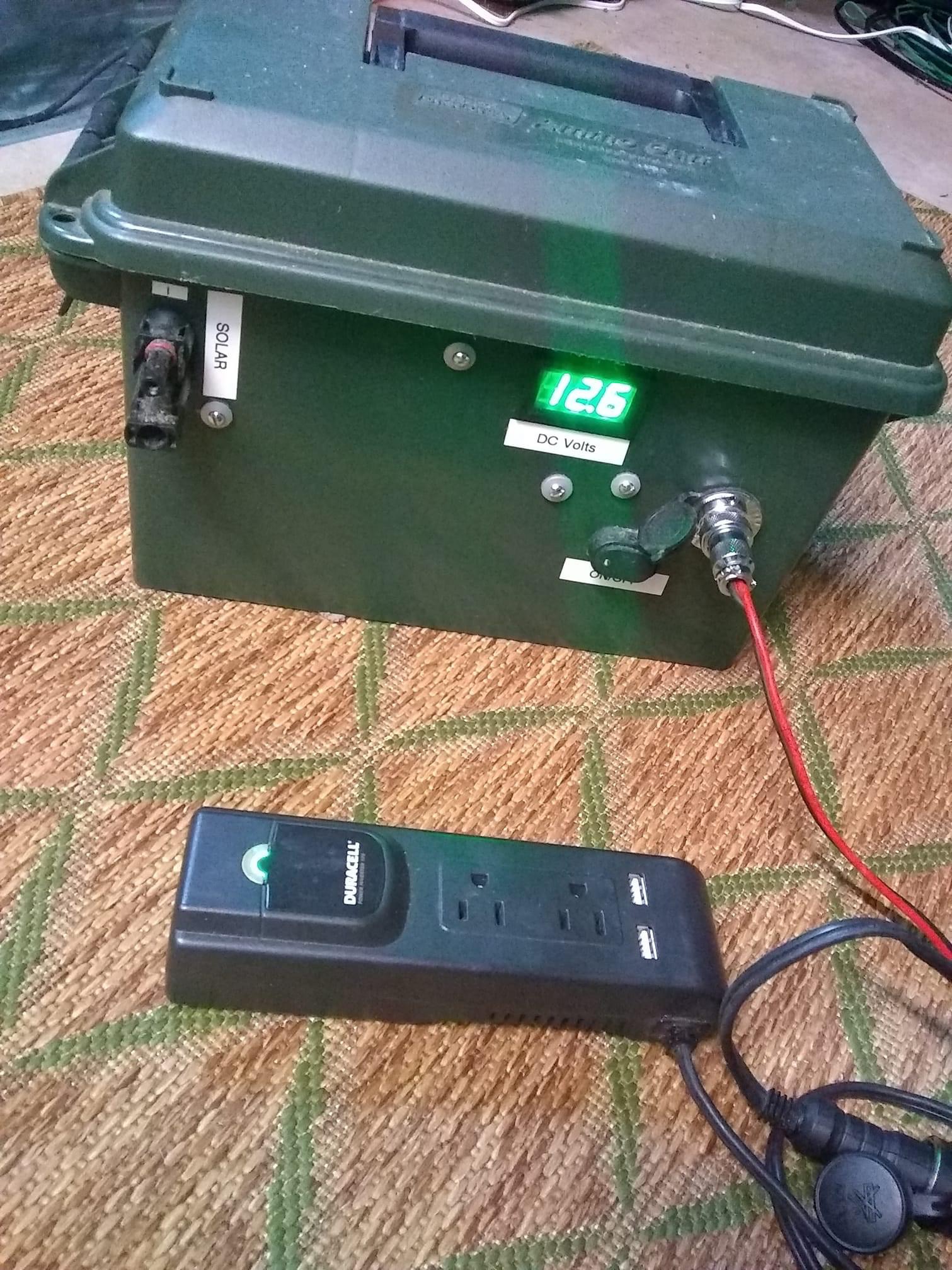

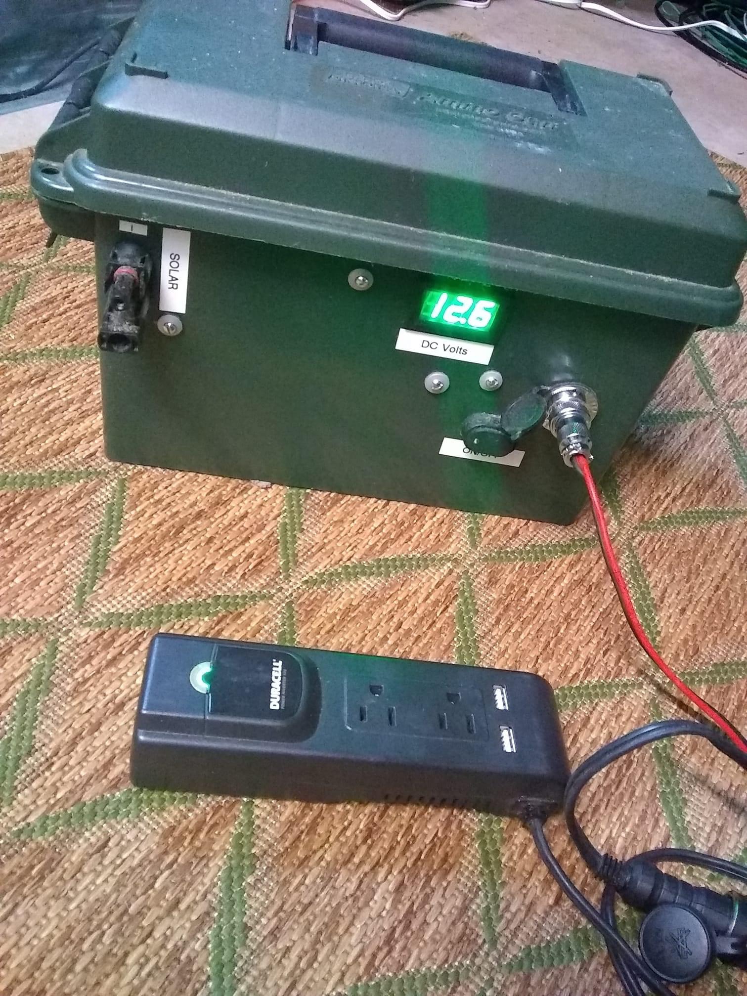

Simple MC4 panel mounts (for solar panel). 20ah battery inside, 10amp solar controller, and I used a 3 pin aviation plug setup to prevent polarity error. Here it's shown with simple 110v 190w inverter you run a small fan when power went out. Again never used a panel with it yet but a 50w-75w would be overkill to charge the 20ah battery.
I was wrong earlier. Just a plain poly 50 cal can (not FAT50)

If you could post some pictures of your new setup, that would be great. I am going to put a can together to take on beach trips. I have a Midland GMRS mobile and an Anytone Smart that I plan to stick in it. Might make a good command center for the golf cart too. Haha!

I'll try to get a couple photos this evening... here is one I have available...
