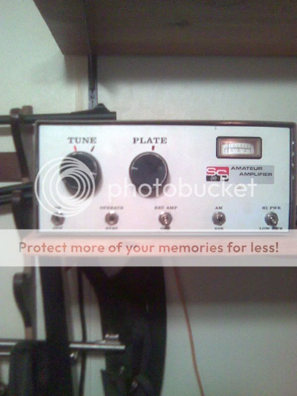

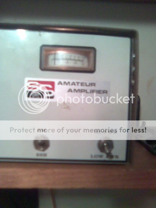

MY SCP old tube amp
Gee I would love to find any info on this amp? it works great, but the pre amp makes the recieve have a hum? makes people sound electronic, but it works
As you can see it is well protected :thumbup:

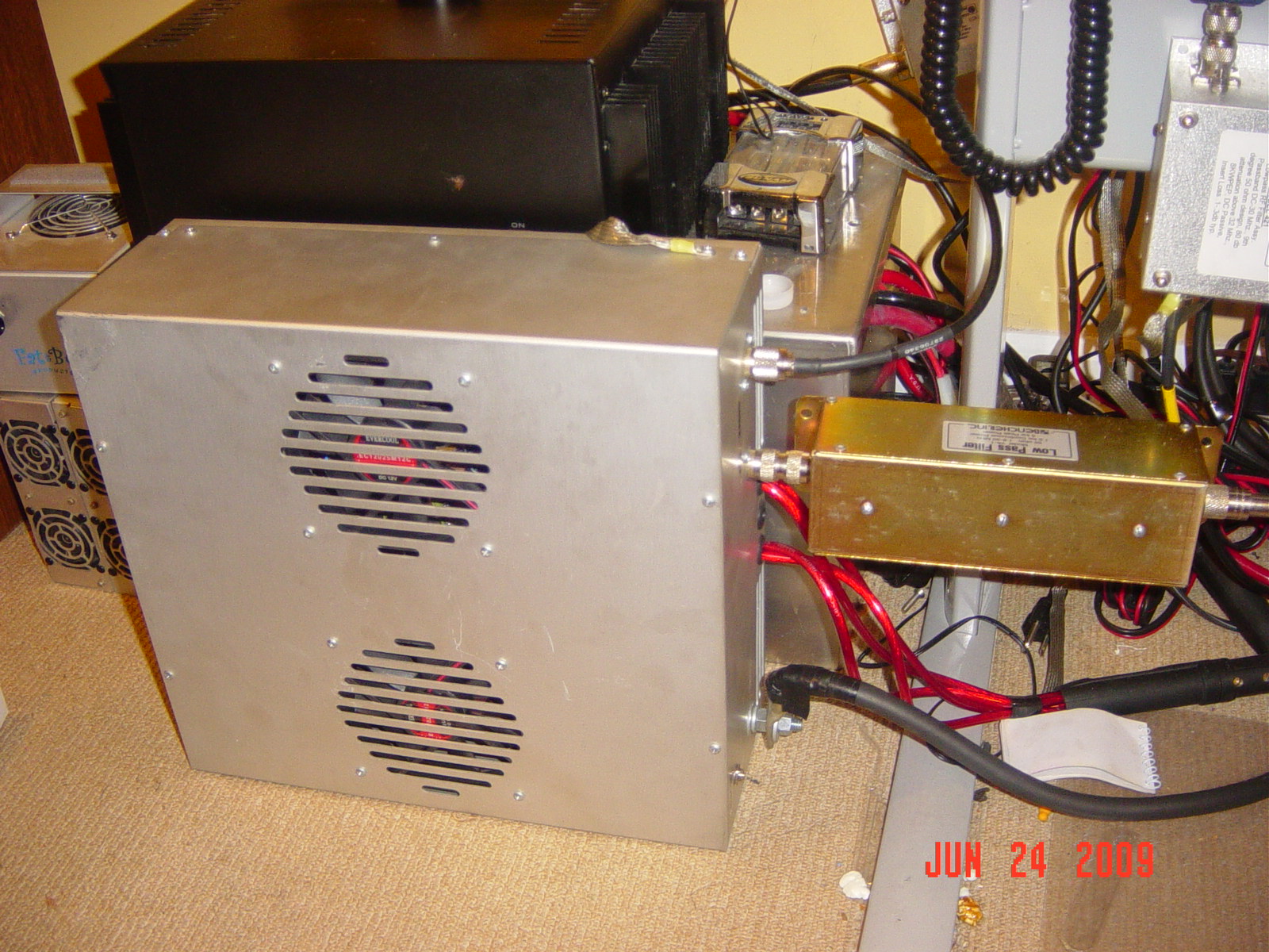

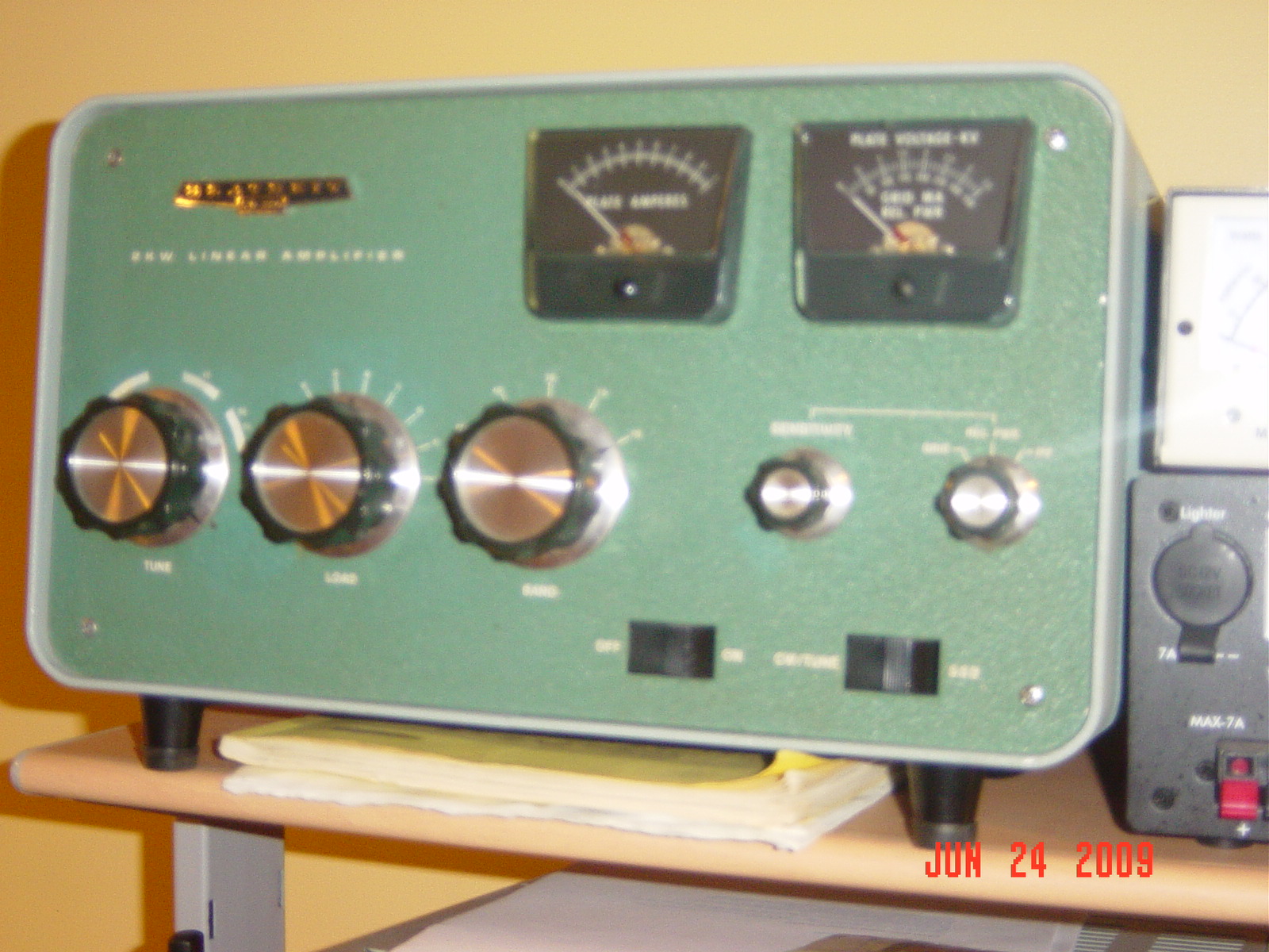

Here are two of the smallest from my collection. 1st is my Heathkit SB220 the work horse in my shack. 2nd is my B bias (12) 2sc2879 Xforce Mud Duck Stomper.... Notice it is heavily filtered. Both are hell in DX land when dumped into my BEAM.

Palomar 321
That is Palomar 321 that someone put a SCP sticker on. Electrically they are a Skipper 300, one (1) driving three (3) and most likely running 6LF6 or 8950 tubes.
