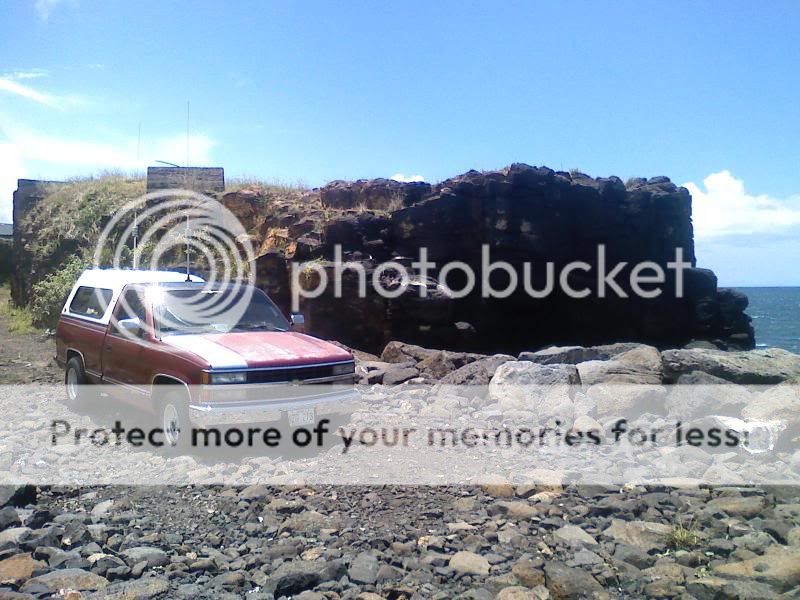

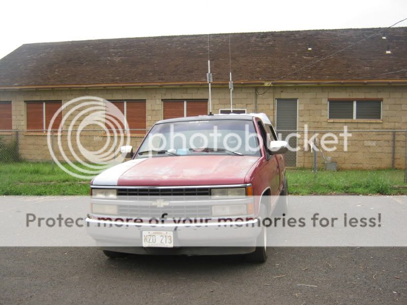

Love both of my 10Kʻs. light weight and gets me out there rather Im barefooted or Juiced up.
