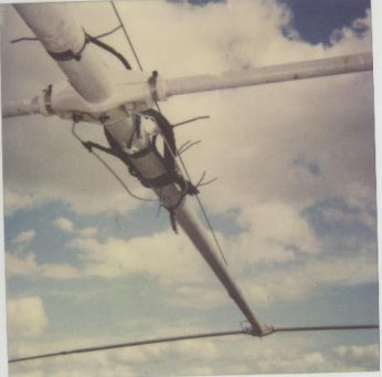

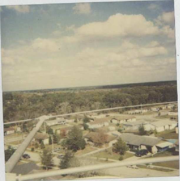

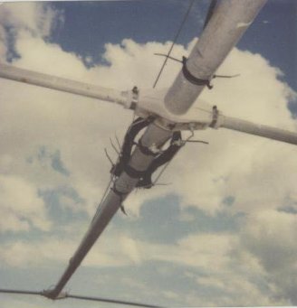

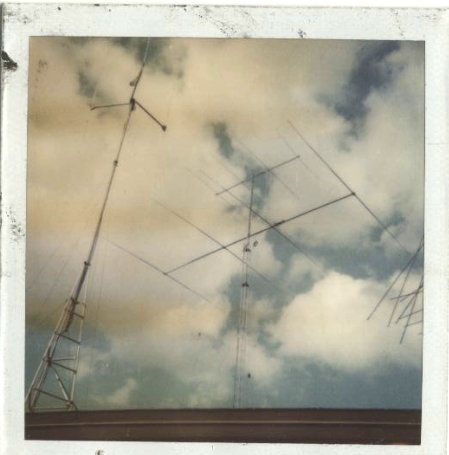

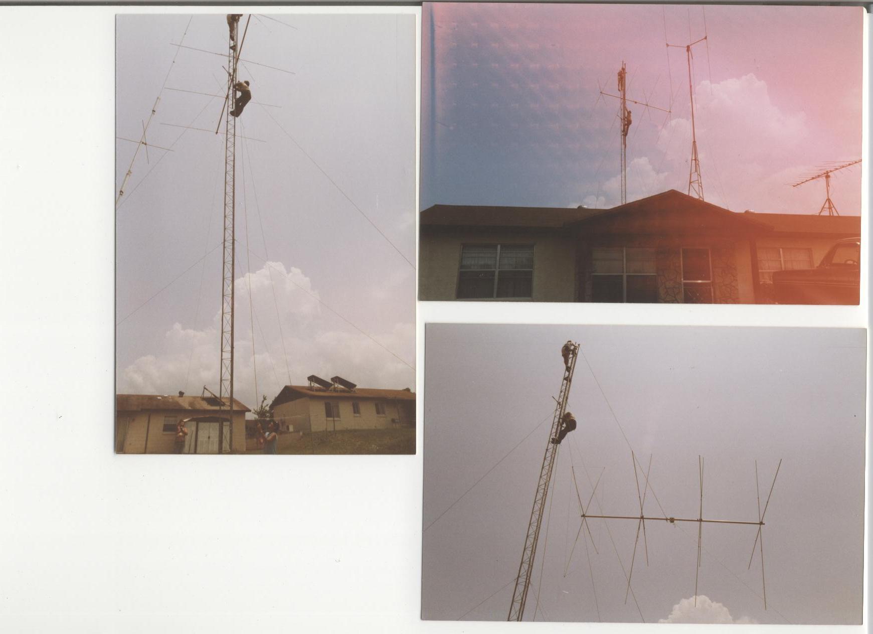

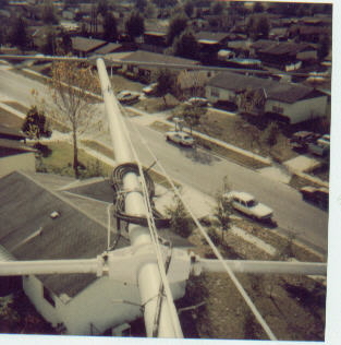

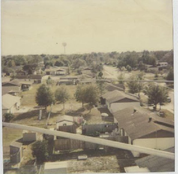

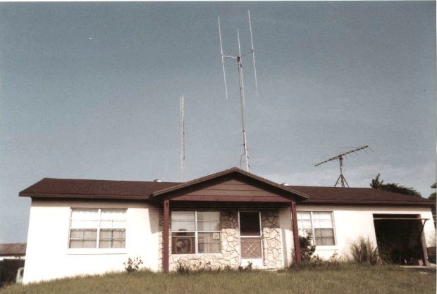

While I am contemplating what weight sledgehammer to use on this digital stuff, I figured I would take a break for a while today and post a few pict some may want to see of my tower installation "way back then"....(if not appropriate here, admin tell me and I will remove soonest.
EMPTY TOWER - 11 METER ON ROOF
HOISTING 11 METER WILSON SHOOTING STAR BEAM
VIEW N FROM BOOM OF 20 M MONO-BAND BEAM
VIEW S FROM BOOM OF 20 M MONO-BAND BEAM 40' X 37' WITH 4'-5'' BOOM DIAMETER
VIEW LOOKING "DOWN"
Reactions: doffo
