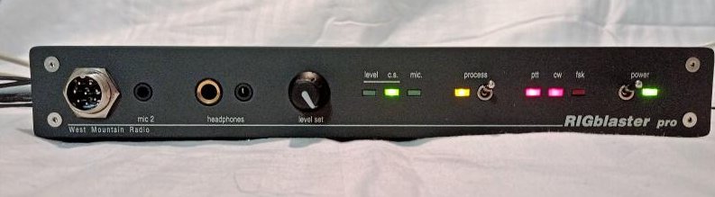

Do this, on the Audio out on the Rig blaster itself, connect some headphones and see if anything comes out.
I AN DECODING CW-RTTY AND HAVE SPEAKERS IN THE OUTPUT JACK OF THE RB AND CAN HEAR FINE...
The knob up front adjusts that signal coming in, so half way is a good start to adjust from there so the signal isnt hammering the radio coming from the computer.
ALREADY MESSED WITH THAT...SAME ...
Better yet, you hook up some speakers to the computer, can you hear it going bezerk when you transmit with the audio coming through it??
I THINK I FOLLOW YOU...WITH SPEAKERS CONNECTED TO COMPUTER OR, TO RADIO ITSELF (ALTHOUGH WOULD BE "CUT OFF" DURING TRANSMITTING), I HEAR AUDIO AS BEING RECEIVED THROUGH RADIO...WITH SPEAKERS CONNECTED TO BACK AUDIO OUT OF RB BACK PANEL, STILL HEAR SPEAKERS AS ABOVE BUT, NO RTTY/CW......IF AUDIO WAS BEING SENT, I SHOULD HEAR IT THROUGH MY "MONITOR RADIO".....

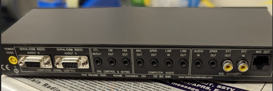

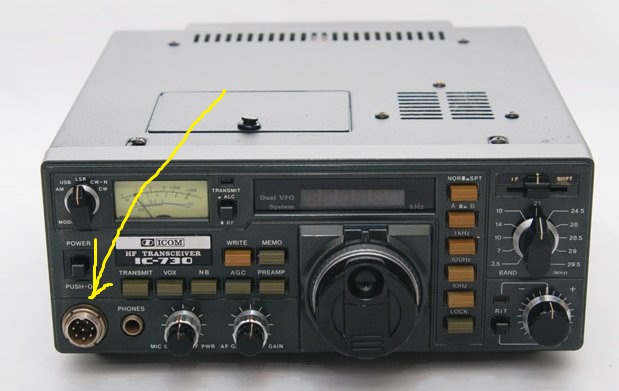

TO NOTE; THE FRONT MIC JACK OF THE ICOM 730 HAS A CABLE RUNNING TO THE BACK "MODULAR" INPUT ON THE BACK OF THE RB.....SEEMS TO ME THAT AUDIO WOULD HAVE TO COME FROM/THROUGH THAT MODULAR OUTPUT TO THE MIC INPUT OF THE ICOM AS A MIC WOULD DO IT....ALL THE INTERNAL JUMPERS ARE CORRECT AS I DID THEM ALL AGAIN THE OTHER DAY....THE BOARD IS LITTERED WITH "OTHER JUMPER BLOCKS"--- COULD BE AN ISSUE WITH ONE OF THEM NEEDING TO BE MOVED?

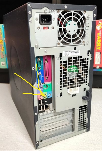

For now, just hook up some speakers to the green port of the PC, see if you can hear all the RTTY stuff when you press transmit. Least so we know the PC is outputting audio.
UPDATE:
I have attached speakers to the computers' green rear output jack as directed,,,,...When speakers are plugged in and I select cw or rtty and then transmit, that speaker jack is muted....
I hear a carrier on the monitor radio but, no typical tones during transmitting either mode.....
I can also connect speakers to the audio out jack located on the rear of the RB Pro and have no problem listening to what the ICOM 730 receives.
I can hear anything I play on/in the computer through that green jack....
I plugged in an ICOM PTT mic and pressed the transmit button on mick and can hear my voice no problem...
NOTE: Should not ALL audio input be made through the ICOM 730' mic jack?
(generic picts below)...
Ok... So the audio is not making it out of the computer. When you hooked up some speakers to it and you hit transmit on the program, it was not making any sound and just muted. Double check your sound settings in the program. But to be sure, can you play an MP3 or at least play something that has sound? To be sure audio in general is working on the PC? I think its narrowing down. And yes, the audio from the computer ultimately gets fed into the mic port of your radio.

THERE IS AUDIO COMING OUT OF THE COMPUTER...I CAN HIT ANY VIDEO, MP3, MOVIE, SOUND FILE AND SOUND IN THE COMPUTER IS FED TO GREEN SPEAKER OUTPUT JACK OF COMPUTER WHERE I HAVE PLUGGED IN SPEAKERS AND HEAR PERFECT SOUND.

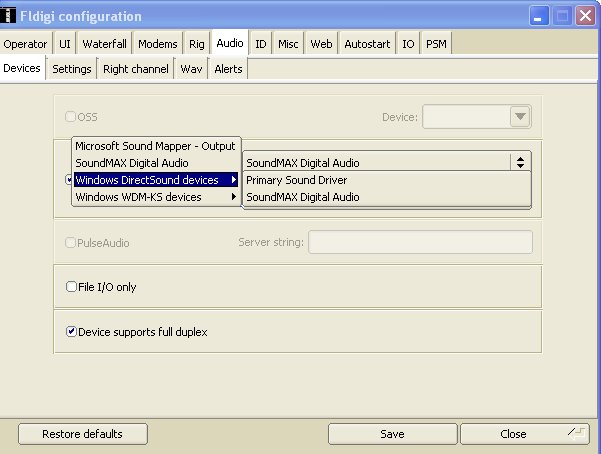

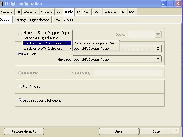

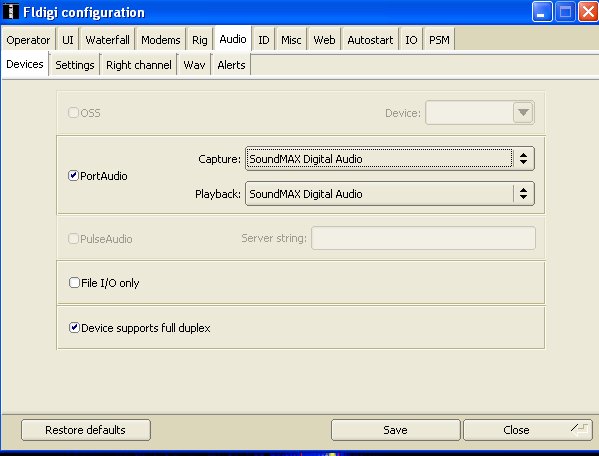

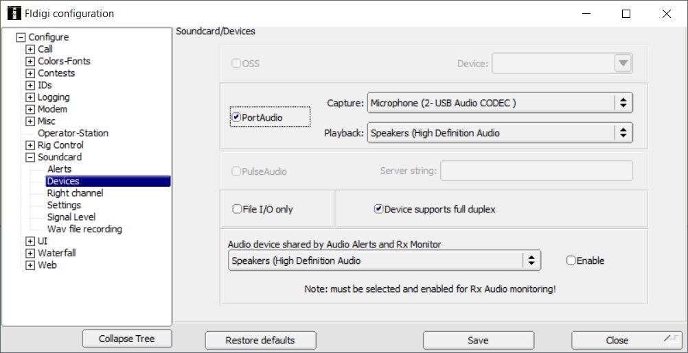

there is settings within fldigi for which sound card to choose. this way you force the program to choose it every time.
choose configure on the top menu and then config dialog. check mark Port Audio and choose your appropriate sound settings. save and close.
I realized that FlDigi didnt even have the PortAudio checkmarked, that explains no audio coming out! But then DigiPan should of at least transmitted audio as it doesnt write to a file.

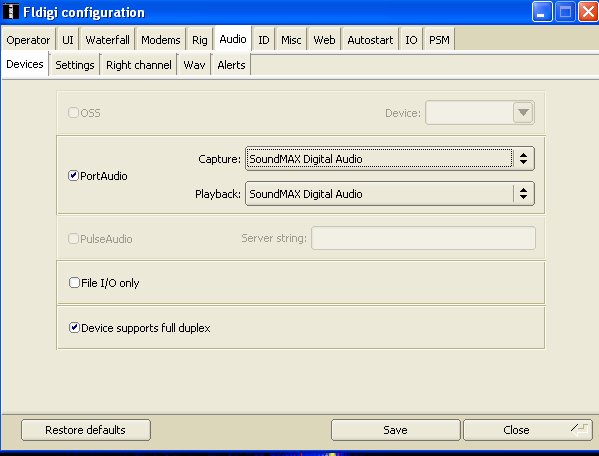

I am using FLDIGI...(forget about DIGIPAN for time being)......I am almost positive that I have it checked...Will look at it now............THANKS FOR THE REPLY(IES).
Both the capture and playback are set to the same thing....I wonder....Will tinker with this tomorrow morning...

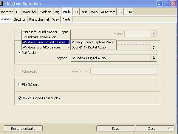

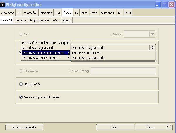

Before I read the above.....I HAVE SOUND AND TRANSMIT!!!!
Where the window(s) I had posted says "sound max digital audio", I neglected to make any selections from the drop down arrows but, randomly made selections in both....AND IT WORKS!
