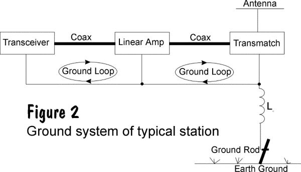

A ground will help but dont make it an "Unground". Each coax needs to be choked so the ground wires will be the only RF ground. Otherwise you will have ground loops. The station should also be isolated from AC ground too.
http://www.radioworks.com/nbgnd.html

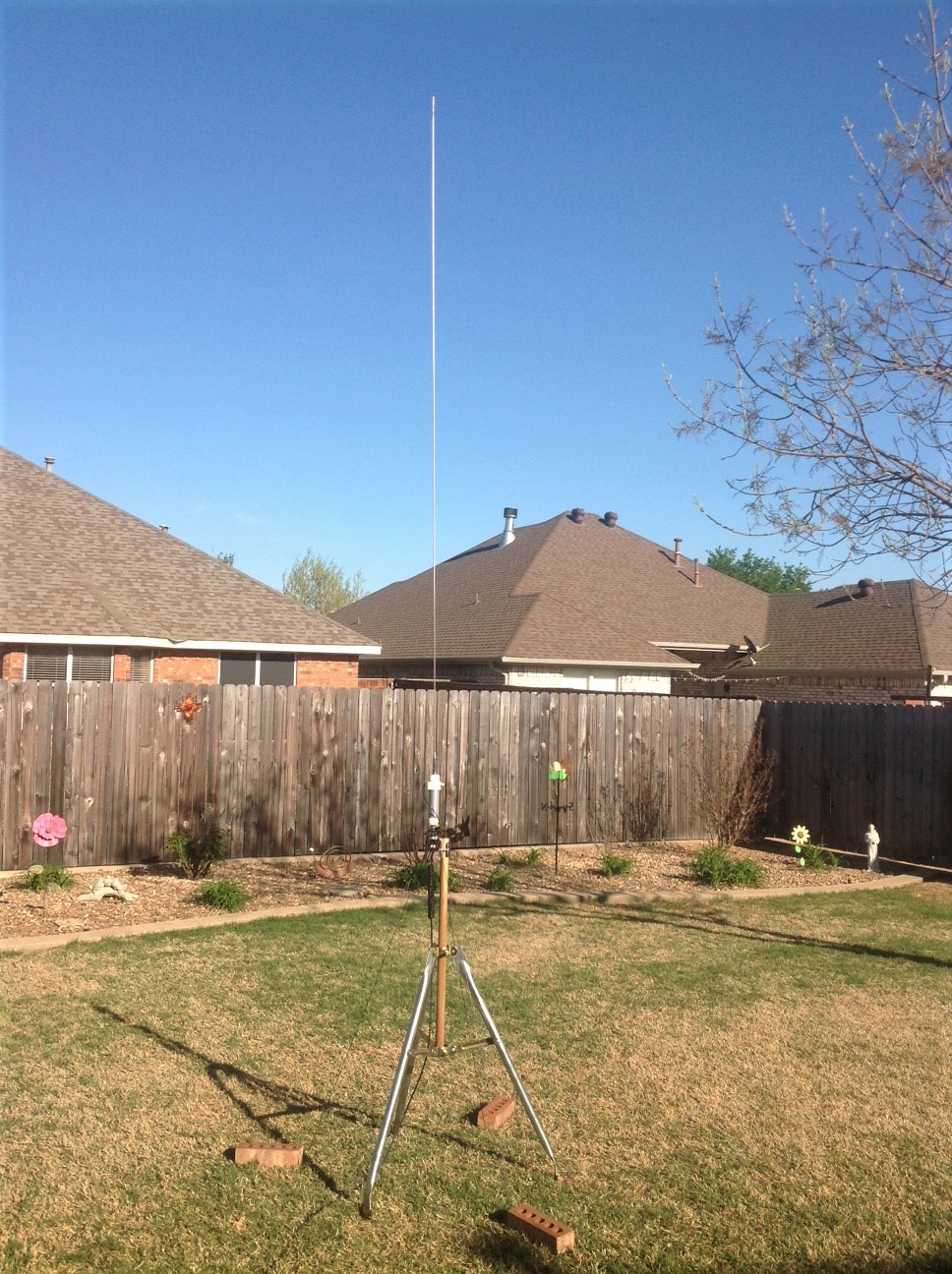

Well, after four days I am back to my Wolf River Coil vertical.
Because of its relatively low center height, my inverted V dipole was actually closer to being horizontal than an inverted V. Don't know if that or propagation was to blame, but it made a pretty good NVIS antenna. I talked to Arkansas and Louisana from Texas and I am never able to talk to those states. Found myself talking mostly to Missouri, Tennessee, the Carolina's and such. That was fun for a while but I prefer a longer reach. And the vertical does that. Am guessing the lower takeoff angle is responsible.
As before, the feedpoint is only 4' above ground. This time (being lazy) I only installed a single wire radial (16.5') sloping to a lawn ornament about 2' above ground.
SWR:
1.2 @ 14.150
1.1 @ 14.200
1.0 @ 14.250
1.1 @ 14.300
1.3 @ 14.300
Working great!
Wolf River Antenna.JPG (Old pic taken in winter)
I know some of you are probably thinking, "Who gives a flip?" and that's okay.
But sharing experiences and info is what this site is about and that's all I'm doing in this thread. And others. :)

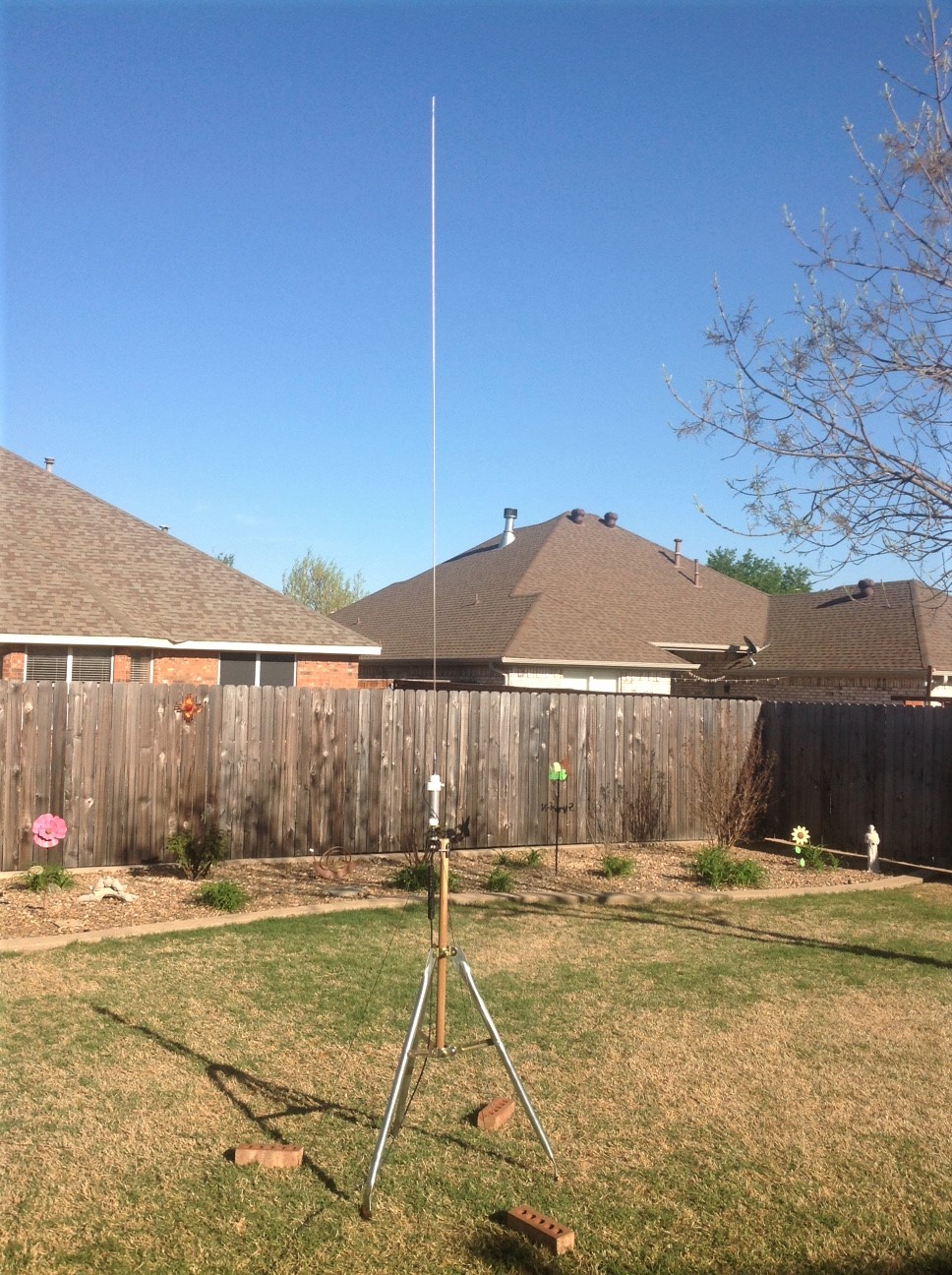

SWR:
1.2 @ 14.150
1.1 @ 14.200
1.0 @ 14.250
1.1 @ 14.300
1.3 @ 14.300
Working great!
View attachment 29535 (Old pic taken in winter)

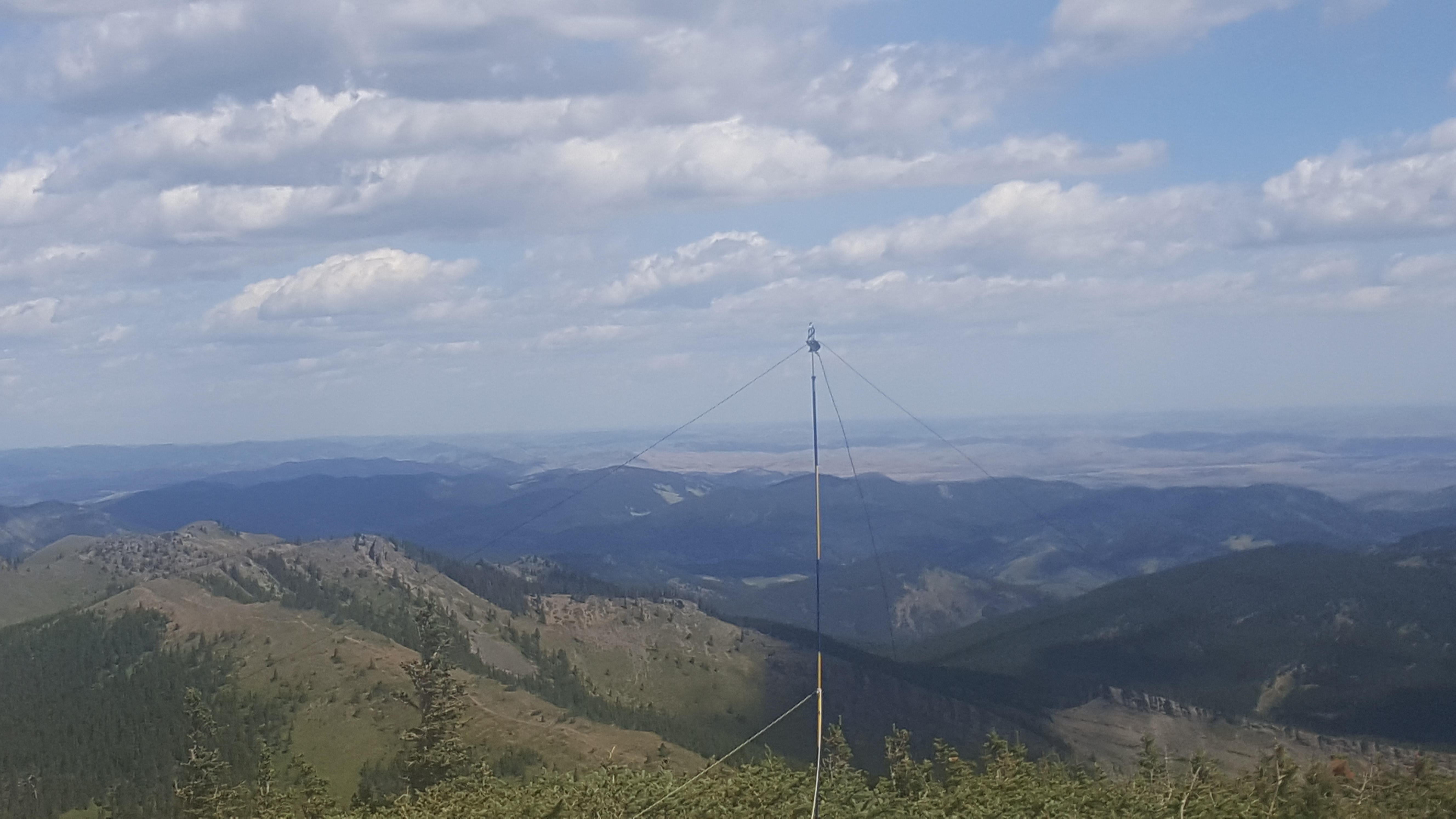

My low height inverted vee supported by a 8'6" avi probe, dipole is for 20 mr. Numerous contact NA as well as NZ on 1 occassion.
