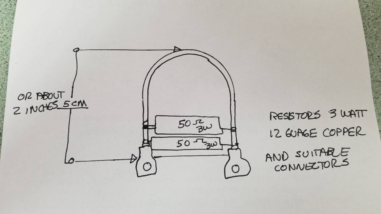

Does anyone sell parasitics suppressors for the sb220 online anywhere.. found some on eBay for $17 but they come out of France four to six-week ship time
You should be able to make these there is nothing special about them I have constructed the hairpins which arguably are better than the inductor types.
Sorry I sketched this at my business computer and scanned it in as this is what I have always used not just on 220's but other amps as well.
I wish I could make something like that.. I would pay somebody whatever it would cost to make them and and for there time before I put my new tubes in.. I think I could handle soldering the one in on..
If you can solder you can make the suppressors. Find something round and wrap the wire around it to make a smooth bend. If you don't feep confident that's ok but it's an easy project.
