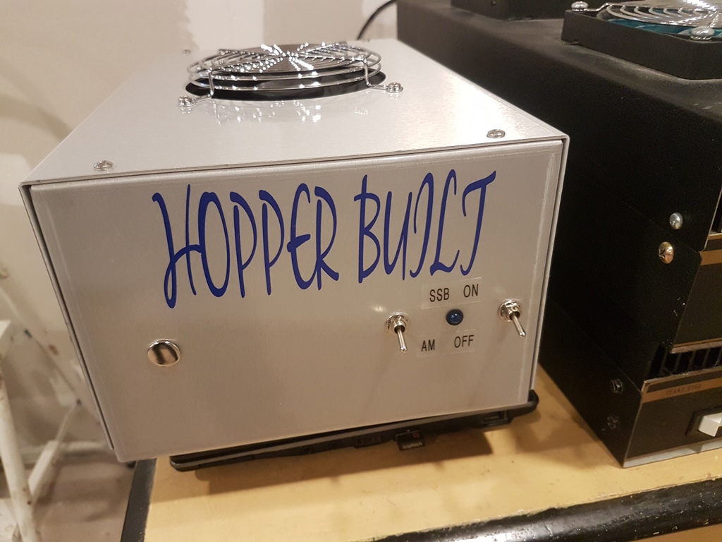

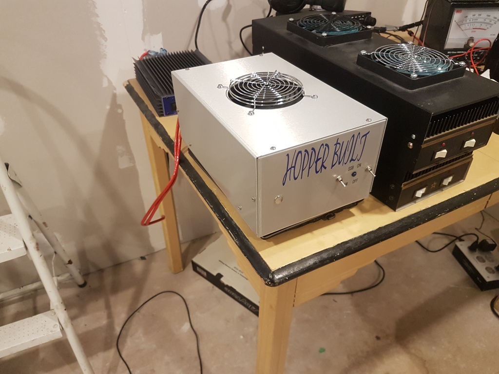

Had to have a boo inside so here are a few pics.
I do see a couple of small issues that won't impact performance much, like missing balancing resistors on the 3 port input splitter and no diode mounted on the transistor to thermally track the bias. The one problem I do see that could cause a failure is the use of the orange ceramic disk padding capacitor across the output combiner.
Ceramic disk caps used at this power level are notorious for heating, shifting value or arcing. The trouble is finding a decent cap that can handle the RF current, without having to jump all the way up to the overkill of a doorknob here. If I were Hopper, I might check out some inexpensive ATC multi layer, leadless, surface mount caps in this place. If one fails, parallel a pair at half the original pf value.
If you could add 20 to 30 dollars to the cost of the amp, just put a doorknob in its place and you'll know it will never fail at this power level.
One thing I will say about biasing HG’s. It’s tricky. 0.5- 0.55v is max bias for HG. At 0.55v they are turned on hard. Full conduction. Actually have to just barely bias so not really turned on, just before they turn on. That should tell you all you need to know about device.

Finally received the Hopper straight 6, bummer I cant try it out as I am short a ps at the moment, anyhow looks ok from what I can see. After I test drive it I will open it up for some pics of the work inside.
Finally got around to powering up the straight 6, with around 80w pep produced just over 1300w at 13.8v, sure it could be driven harder but seems good enough for me. On the shelf it goes.
