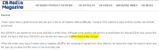

I've been researching some other radios to see what folks say about the noise on them compared to the hash that's described on the Q5N2. and what I experience myself. Actually I just don't feel like doing any real work today. Just kicking the can today, so to speak.
Having owned numerous incarnations of the 2950 over the years, I can relate with what's said in that article excerpt ^^^. However, my 2950's never had a meter that show a constant noise floor on the meter, when there is none. But a "white noise" effect? Yeah...
A friend of mine recently bought a 2950DX6 that has had the receiver optimized, and it truly sounds very nice, without any of that "white noise" hash that older models of 2950 had. His receive is nice and quiet, but also super sensitive. You can easily make out really weak stations, that aren't even close to registering on the meter. In other words, the exact opposite of this 5555N2.
A radio that is listening to no signal, and to no noise floor, should be very quiet, and most certainly should not be showing S-5 on the meter. I think 90%+ people would agree with that.
