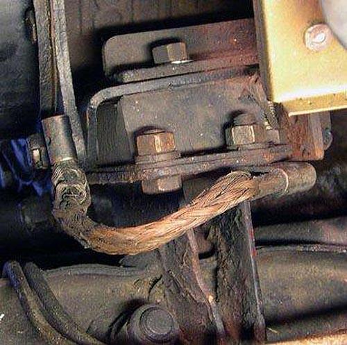

All you need is to get the lowest inductive path for RF to locate ground and a simple copper braid strap mounted from an upper bolt on that mount past the shock rubber mount into the Frame member bolt underneath or alongside is about the best you can do - aside from rerouting onto re-braiding a harness just to equalize the currents from the signals the injector pulse generates - like they do with CATV and Hi-Speed cable and telephone systems to offset their losses in long runs.

Those braided ground straps that always get in the way. Those are bonding straps. You may need to add more.
