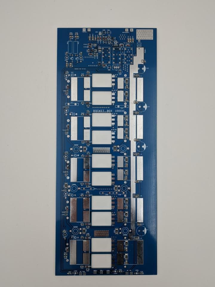

Studying the layout of this board has caused me to become a little more skeptical. Missing are any large conductive areas around the transistors and output transformers. The RF currents flowing trough the ground plane of the PC board in this area are high enough to cause heating. The absence of any, adds to oscillation problems and distorted output. While I can't see the back side of the PC board, there do not appear to be enough feed through connections to place a substantial ground plane on that side and it is in use for other traces.
The board is very small, placing all transistors close together. This concentrates heat into a smaller area as it's trying to dissipate though the heatsink. Effort should be made to mount the board on the heatsink so that the row of transistors are not inline with a small number of fins and are laid out perpendicular to the fins for best cooling. Regardless of the size of the board, it should not be mounted to a heatsink that is any smaller than what you would see being used in an old school 10 pill because we actually have more heat to dissipate here.
The area provided to mount the main output combiner, is not large enough for any part that could handle a KW. The suitable part would have to be raised above the board or relocated off to the side of it. The same holds true for the output relay and five output transformers. All being very small for the power level of the board. A quick look at the unloaded board might suggest inverter or AF applications rather than RF, based on layout.
Hello guys sorry for the delay my login was jacked up this is my new Rocket 1000XL we are building the sample kit to make sure this unit performs like it should
