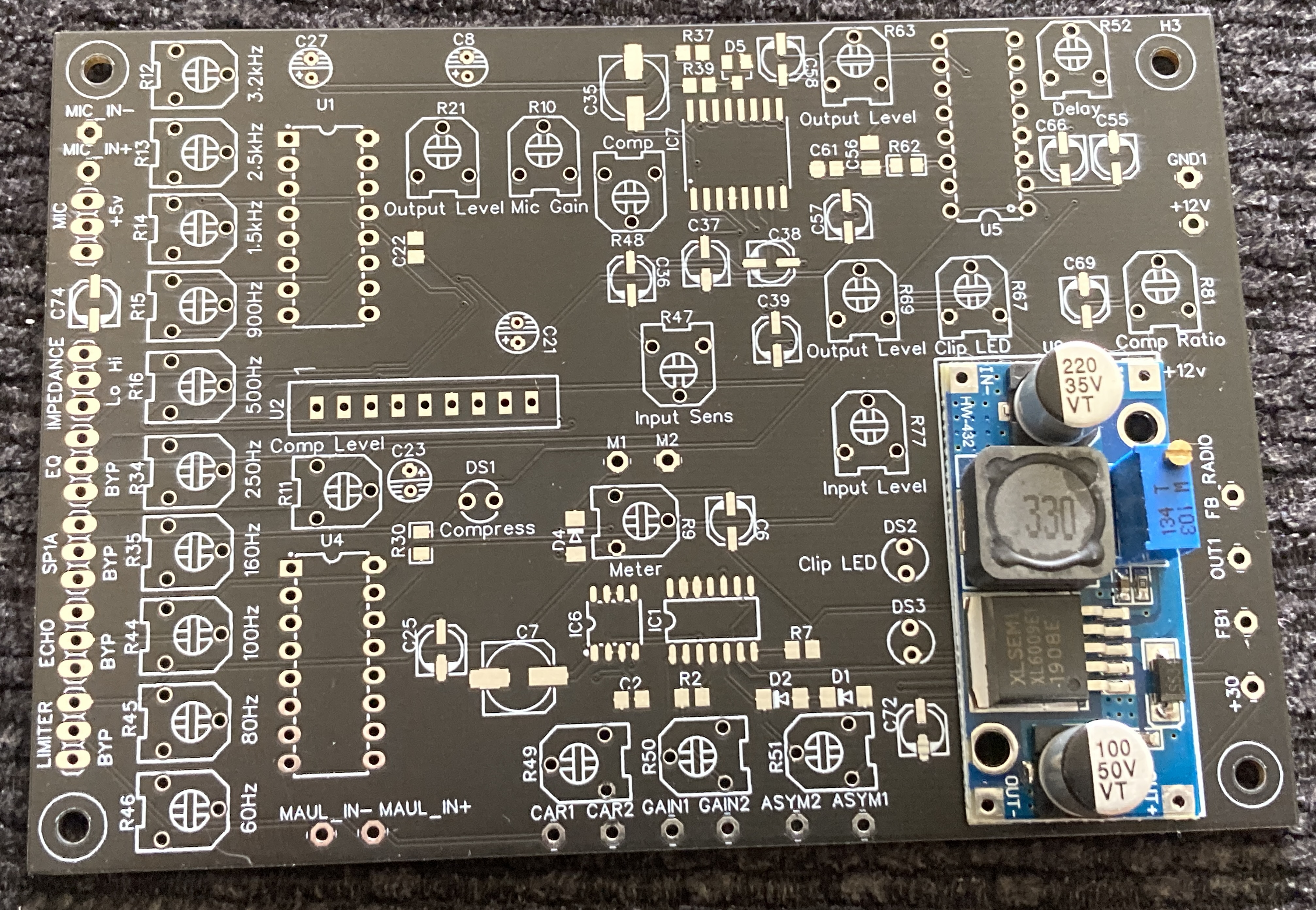

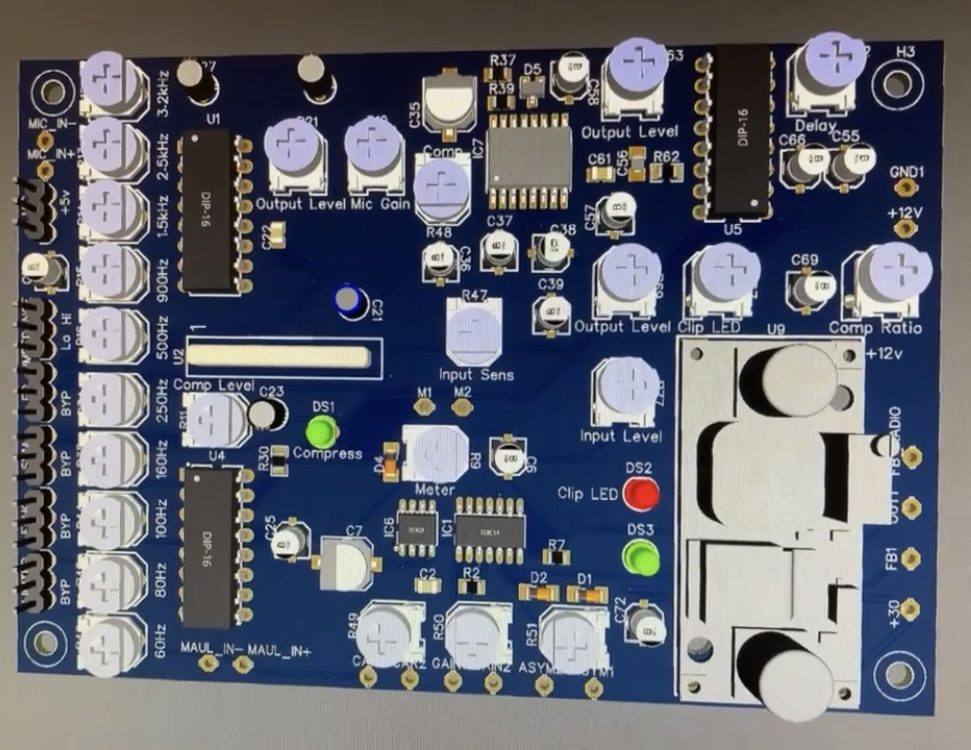

Just made couple to see how it worked in a mobile radio, 10 band eq, SP1A, peak limiter and echo. All bypassed by jumpers but UR6QW EQ is straight off the datasheets, his echo is also straight off some datasheets. Waiting on some parts to assemble.
