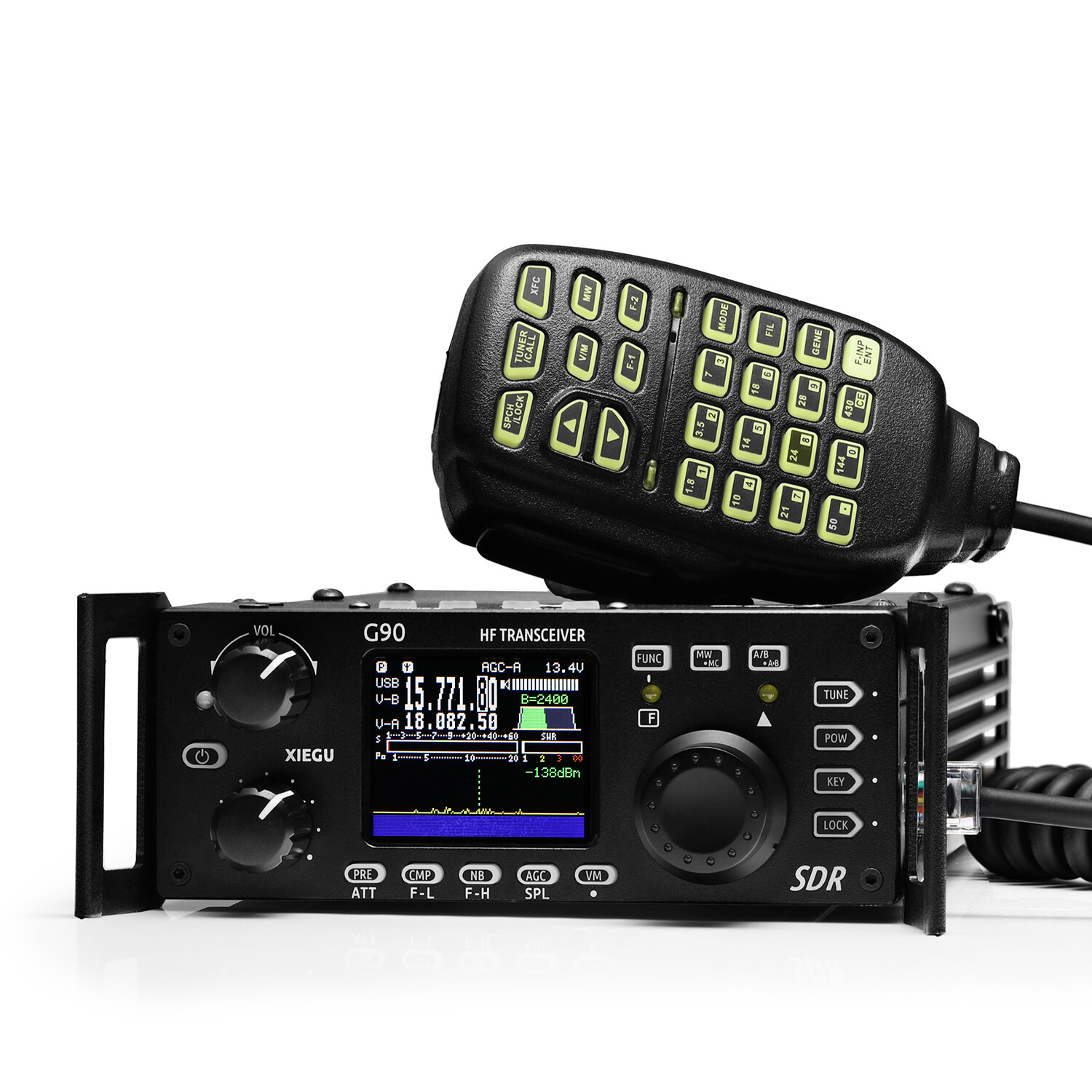

It would be nice if someone made something smaller, that covered all of HF on all modes with good sounding AM, a built in bandscope, antenna analyzer, DSP filtering, dual VFO's, digital volt meter, great automatic antenna tuner, detachable faceplate (cable included), easily modified for MARS and CAP, had real RF finals AND COST LESS. But, that would be a pipe dream right?
Not so! Check out your other options (link below) with newer, inexpensive ham rigs because, it beats EVERYTHING you can buy for 10 / 11 meters.
Xiegu G90 QRP HF Amateur Radio 20W SSB/CW/AM/FM 0.5-30MHz SDR Transceiver US | eBay

That's my next radio - can't wait to try out the G90. Is the front panel user friendly enough to use without the stock microphone? I'd love to be able to use my studio microphone setup into it.

I don't own this radio so I am just going by what I've read from many reviews today, while looking for other alternatives to these "10 meter rigs". Key points that stood out were features, price, size, good AM performance on AM receive and transmit. Good SSB performance is a given on HF rigs but they often "skimp" on the AM transmit.
While the display is small and the bandwidth limited, I'll trade echo and talkback for bandscope and waterfall any day. Give me a clean 20 watts from real linear RF MOSFET's, worthy of amplifying up to whatever needed, over 100 watts from transistors so cheap, it's the only part most manufacturers know they can't even warranty for 90 days on their "high power" radios. These parts have such poor IMD specs, they won't even mention it anywhere.
To answer your question, the radio uses the new style 8 wire RJ-45 type microphone connector. If you're willing to give up the mic keypad, you could just feed audio and the TX key line into the RJ-45. It's probably putting out DC bias voltage on the audio line for the electret condenser mic. If so just block the DC from getting into your outboard audio equipment with an electrolytic cap.
Other possibilities may be injecting audio into the digital input. I read it had one even though it doesn't advertise this mode (yet). You could also feed audio into the stock mic or plug from outside (in place of its element) in order to retain the keypad if needed. Just don't go putting line level into a mic input without the appropriate resistor divider acting as an attenuator.
Another alternative is to make a small "microphone junction box" to plug both mic inputs into. With a switch on it you could go from the stock mics audio input, to your outboard mic gear at the flip of that switch. Could still use the stock mic to key the radio too.
The radio is software defined and there have been several updates. Make sure you are using the latest version with the most features and patches. Updates are said to be easy, but without those updates, not all features may be "plug and play" or work to their best abilities, right out of the box.
