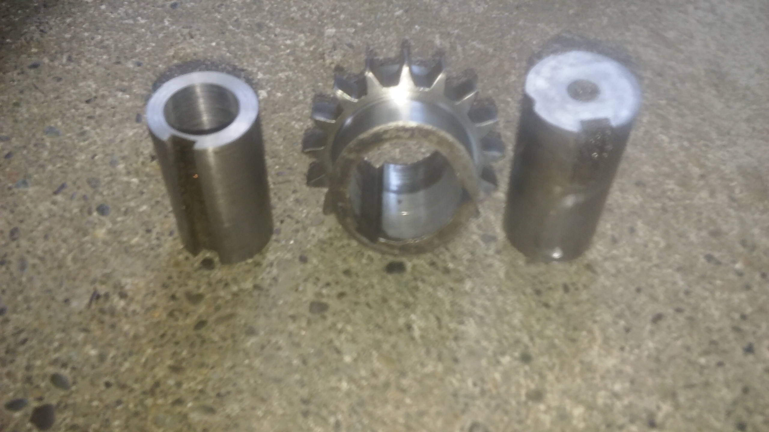

The new shaft is .671" , the old one is of course larger.
I had to do a bit of repair on my Lathe (Atlas Clausing , Sears Craftsman , 10100)
Then turn down the shank on two drill bits. (1/4" chuck)
Then come at the "bushing" from both ends with a ground and modified 1/4" tool holder. I didn't have the shiznit for a boring bar that small.
Fighting tool post flex all morning I finally got a setup that worked.
Rebuilding brother's lathe.

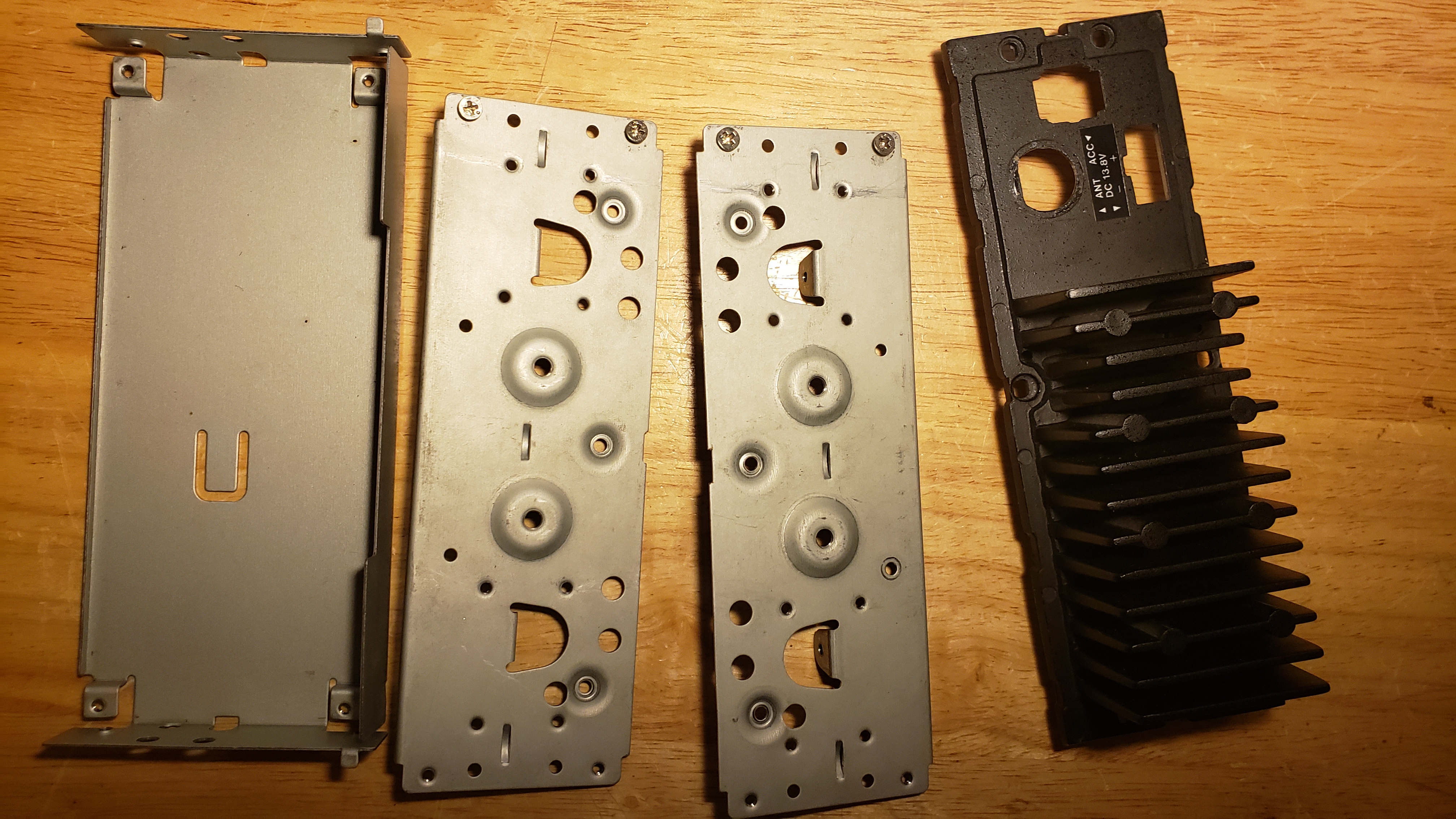

So Randy, 999, and I are going to tell you all a story.
I posted "wanted HTX-100, 2510, 2600 , chassis parts"
A deal was struck and Randy sends it all off within a few hours.
The covers I received had a cut out for a side mic. Oops.
The email from randy confirmed it.
So he sends out the correct covers and I temporarily loose either my mind or the incorrect covers, or both.
Yesterday I find the covers in my roommate's hands as he says " these aren't the right covers..."
I sent the covers to work with her and hope to get them returned before the weekend.
So many thanks to Randy for the deal on the chassis and many pics to follow from that.
Regrets to Randy because he got tangled in my BS trying to get the covers back.
If it happened to someone else it would be a little more humorous.
Reactions: 999

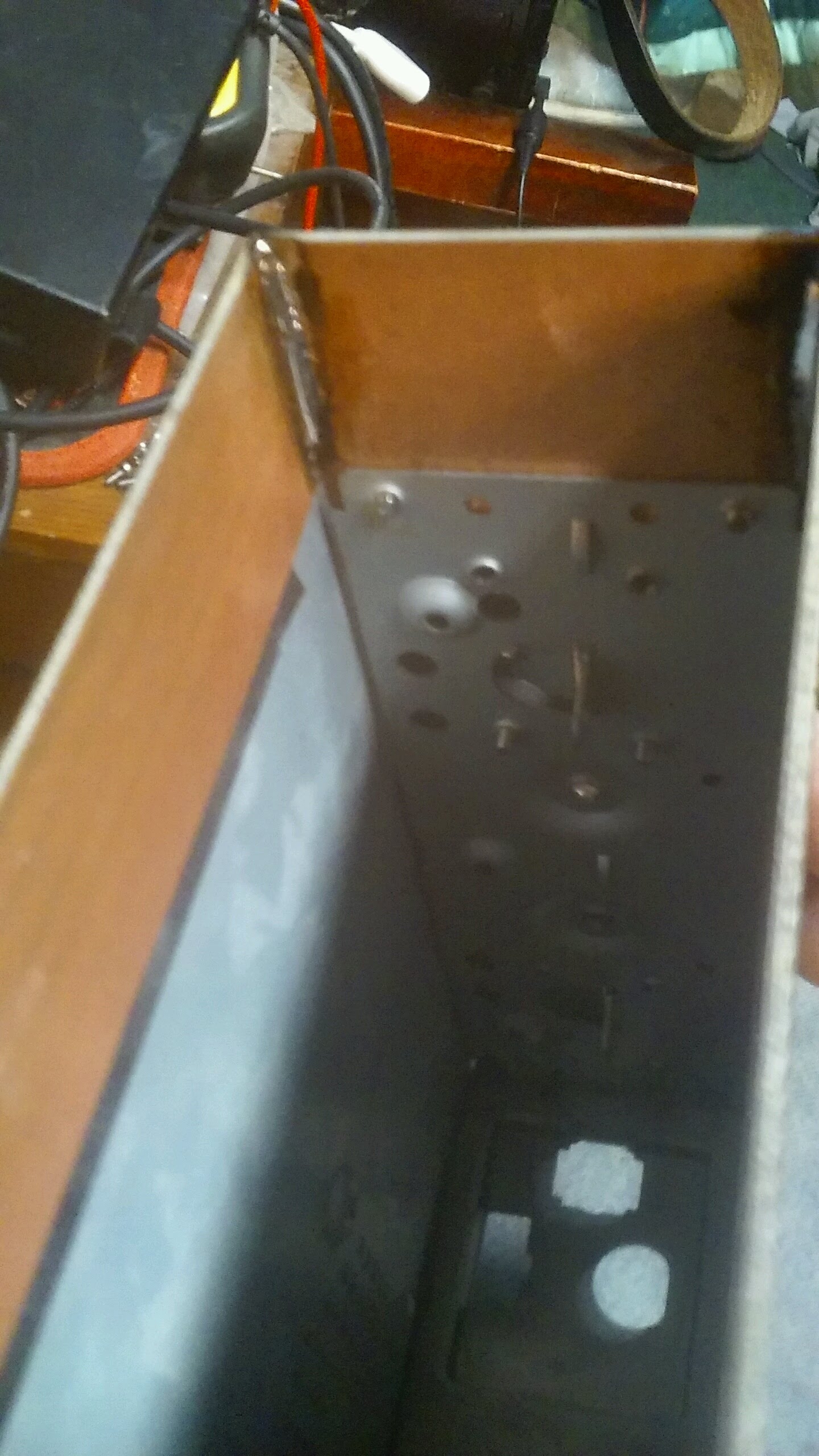

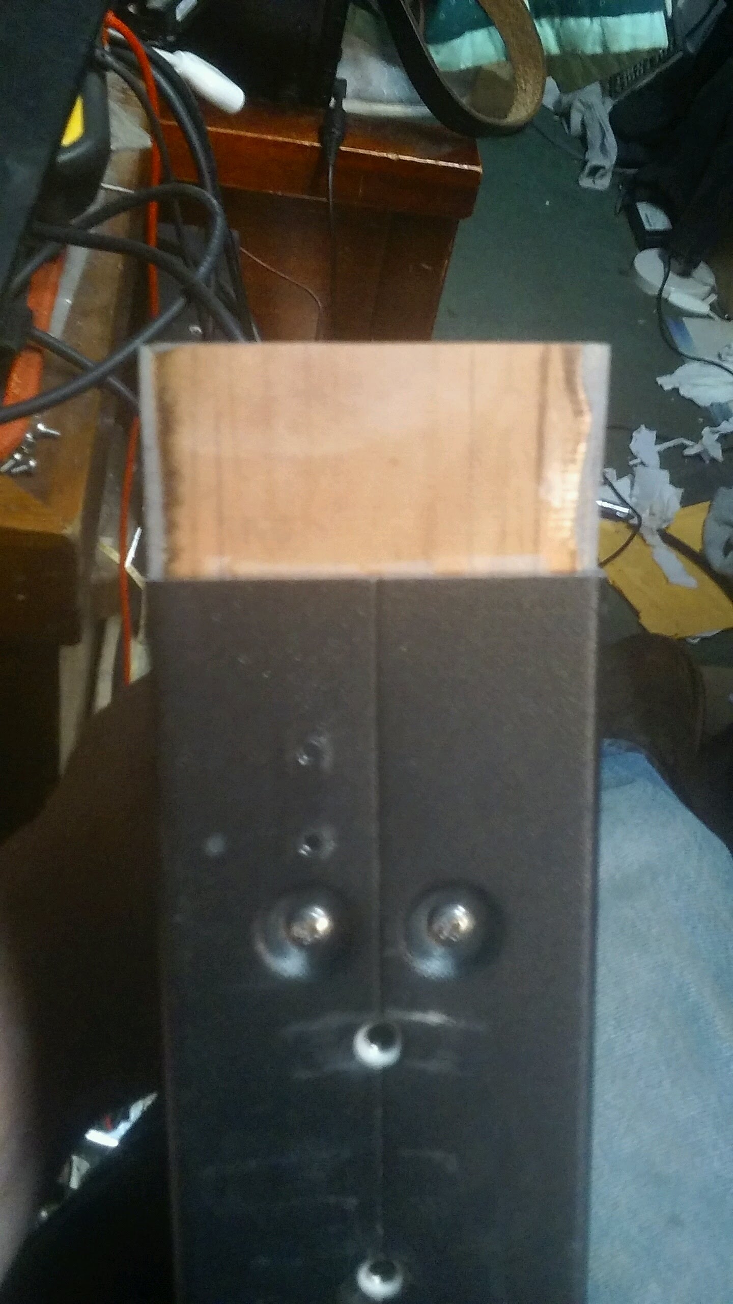

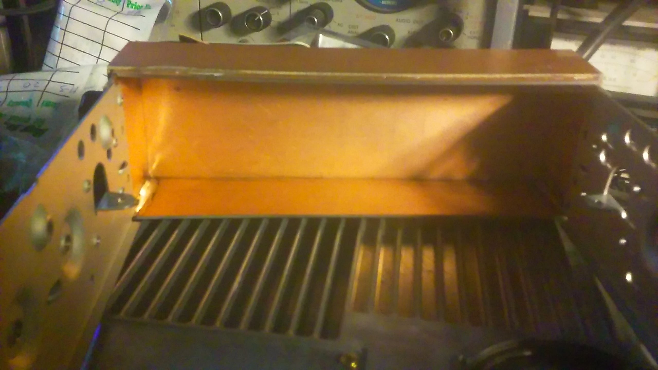

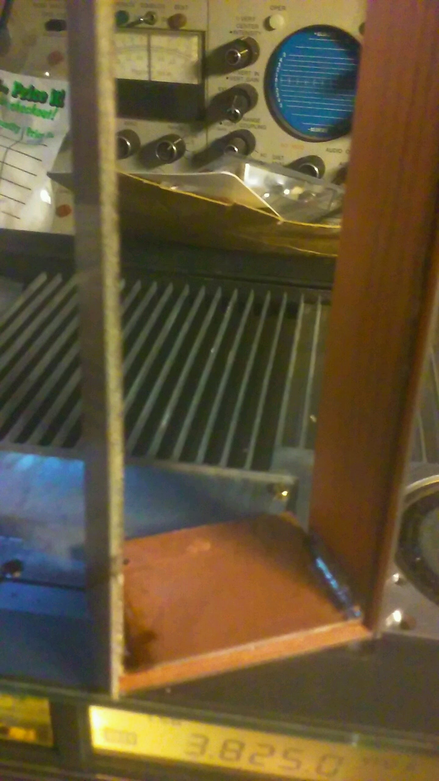

Usable face area is 2 1/8" x 7" . Now to play Tetris with the TFT screen , main tuning, volume, agc, self destruct...
I gain a little bit of depth and loose it to the display.
I get a heatsink with undrilled bosses for sub 1U fans.
Complete the RF enclosure. (it s copper...)
Now the project forks in three directions.
Complete the face
Play Tetris with the heatsink
Adapt the side rails to the main board
and so it goes
View attachment 30533 View attachment 30534 View attachment 30535 View attachment 30536 View attachment 30537
Complete the face
and so it goes

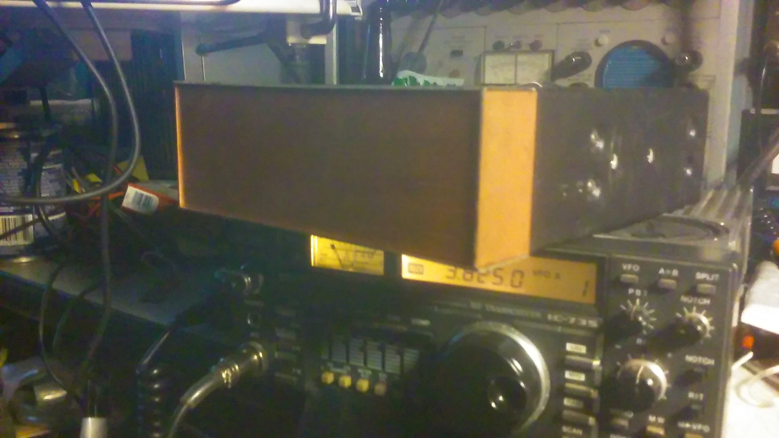

Plenty of room for the DC/DC perverter, NXP because life is too short for QRP, and what ever else I decide to stuff in the now unused computer tray .
So far it's been easy. Now to breadboard the uBitx and actually get it running.
This is where the real work starts. I'll be on to other things briefly (that possessed by Beelzebub IC-735 for one) and I'll get back to this as soon as I wipe out a long list of over due ...
