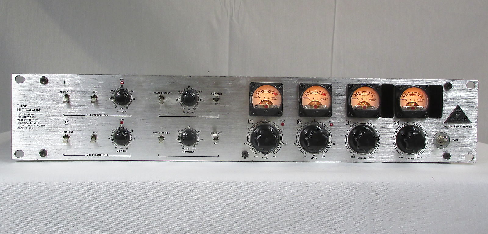

So, use marginal op amps and limited power supply filtering along with generally horrid design then add a curious implementation of 12AX7 tubes to produce even more distortion and call it not only a feature but the primary design element...
umm, yeah

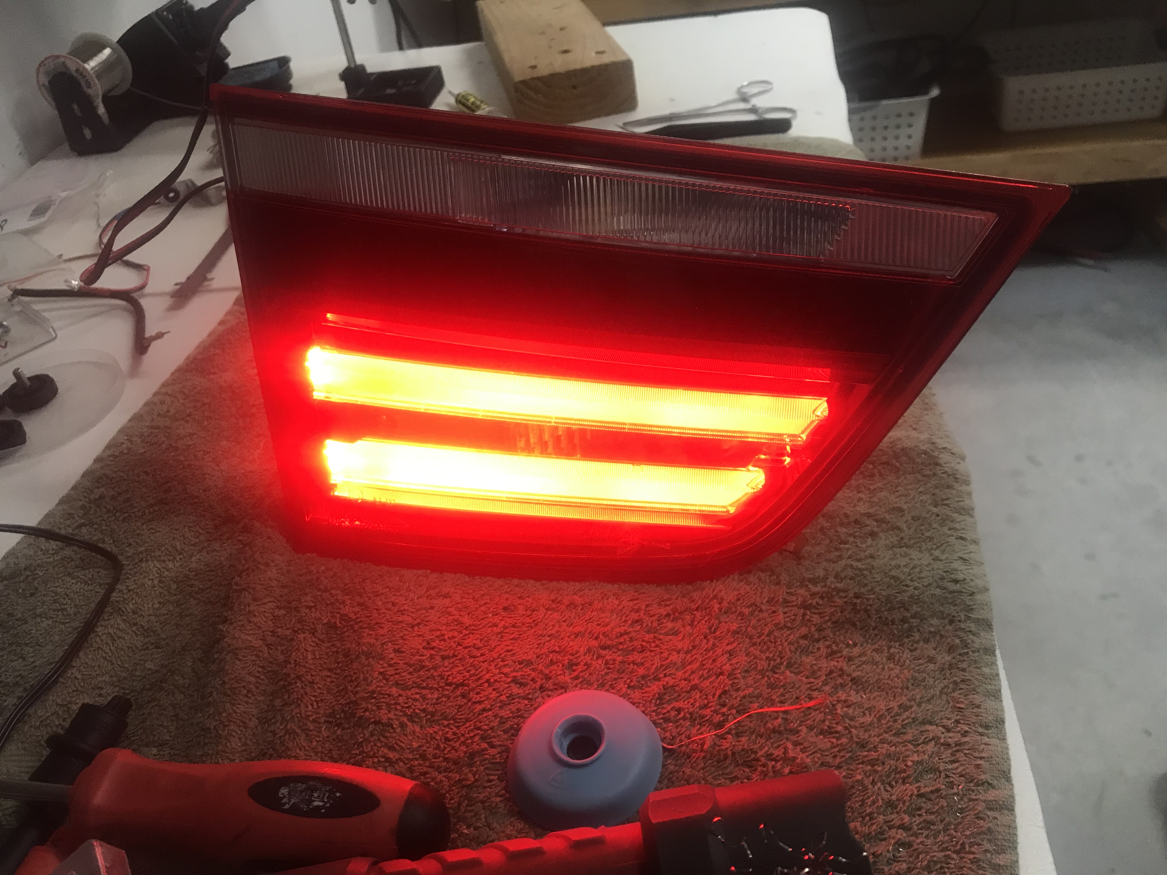

The wife’s car has 4 separate light assemblies on the rear. 2 of the 4 currently aren’t working. BMW wants $600.00 each for them. Found the LED driver (TL4242g) not working/intermittent. With a lot of patience and a couple magnifiers, I replaced them all. I did waste 2 new ones but at $2.53 each (I ordered 6 of them in anticipation of a Senior moment) I still saved a bunch of money!

Dmans , Are those the Cob LED light strips w/ double back tape ? If so I bought a few for the wife's Rhino . I can't believe how cheap & bright they were .

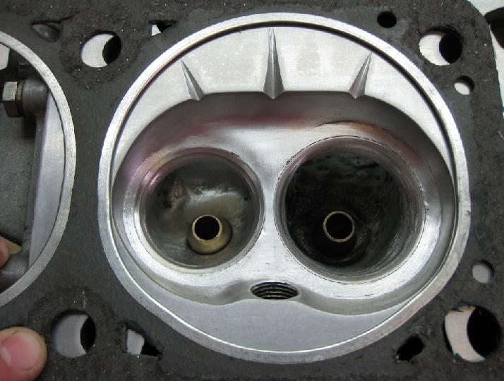

Cut, zero deck head. Wide valve spacing as well...
